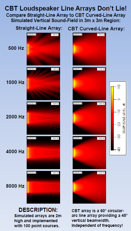

Indeed, my curiosity was about how CBT can achieve DC with multiple speakers on a curved stand.
Much has already been said and there is currently a CD thread using horns, so I opened this separate thread.
Here is a paragraph that caught my attention, and that seems to be quite extraordinary if true....😉
Don Keele's CBT (Constant Beamwidth Transducer) Page
“Figure 18.3 shows a small sample of the informative sound field simulations in the paper. (……….) How did (e) and (f) sound? Excellent—at least that is the author’s opinion from a biased, sighted test. It was distinctive in how little the sound level and timbre appeared to change with location in the room and how the loudspeaker did not get “loud” as one walked up to it.

CBT is constant vertical directivity. Its horizonal directivity is that of the drivers of which its made,
Keele explored multi-dimensional arrays.

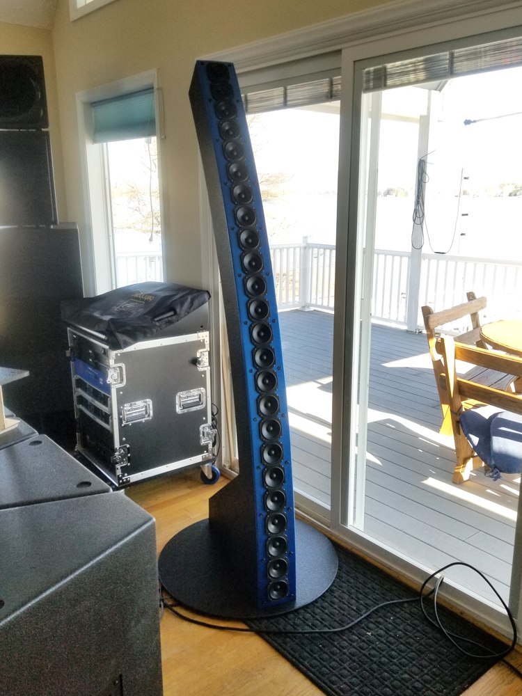

Hi, i built a pair of CBT's using 24 TC9's per speaker.
They have been the most room-neutral, even coverage, speakers I've built.
Very nice sound, particularly the midrange. No directivity index issues at all, after EQ. (they did require subs for my taste)
I think a big part of their design, over and above the typical line array used by the prosound industry, is the curvature that works with floor reflections to minimize combing. (May work with the ceiling too, but i'm not so sure there, given differences in home ceiling heights.)
The cost really wasn't that much. Gotta love the price of TC9s 🙂
Two 4x8 sheets of 1/2 baltic-birch covered the cabinet. Biggest challenge was building a 22ft diameter circle jig for the router, to cut the arc needed.
