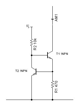

constant current source
Although a simple JFET (or a depletion-mode MOSFET) CCS won't have as high an impedance as the ring-of-two at low frequencies, it will maintain its CCS behavoiur up to a higher frequency. This is because of the 'Miller' capacitance causing NFB that lowers the Z-out of the 'ring' circuit as the frequency increases.
Also the 'ring' circuit hac poor dc performance over temperature, as the current setting is determined by the Vbe of the bottom transistor.
I've seen people using 'ring' constant current loads for long-tailed-pair double-triode phase splitters in valve amps who wonder why the phase splitter performance is so poor at higher frequencies!

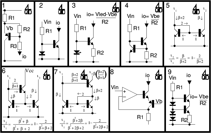

lumanauw said:
Anybody knows what constant current source that can work properly only under 0V3?
In figures above all needs more than 2 diode/VBE drop to form CCS.
Current Mirrors can have drop lower than 0.2 Volt.
Say you want a low drop current source from negative rail.
To feed a dual NPN differential pair.
You then make a current source from POSITIVE rail
and under NPN pair, at negative rail,
you put a simple (two transistors) current mirror
to bias the differential pair.
To increase precision, if you need very good precise current source,
you might even use small value emitter resistors
in the two transistors in mirror.
Say with only 0.05-0.02 Volt volt drop at chosen current.
This will lower the saturation margin, Vce in mirror transistor (Vce 0.25-0.28, instead of Vce=0.30)
So, if you do not need absolute highest precision,
you should use a current mirror wthout emitter resistors.
To maximize Vce and avoid saturation in mirror transistor.

Cant you do as I said.
Make a constant current source coming from V+ (positive supply rail)
using two PNP transistors, or two diodes and one PNP with an emitter resistor.
This current is feeding a current mirror, using figure 5 in CCS and mirrors alternatives, in an earlier post above.
Current mirror is two NPN attached to negative rail.
With the mirrored current output connected to Q3 base.
I do not know if i can tell it more clearly.

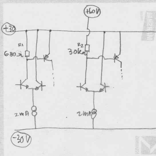

Hi, Ilimzn,
Yes, at first sight putting current mirror at Q1-Q2's collector seems the same as my intention. But it is different. Mirrored ccs by right leg differential is not constant at all. Putting current mirror between Q1-Q2's collector makes the gain doubles, but not lower the distortion caused by Q3 base (non constant charge suckout at Q3's base)
Transistor is not good at 2 things. Fluctuating voltage and fluctuating current. In VAS collector, some people cascode the output collector to minimize fluctuating voltage (early effect). I'm trying to experiment with fluctuating current here.
In position of R3, the non-constant current (because of relation I=V/R) is worsen to the final result, because this non-constant suck out is directly feeded to base (Q3's). As a result, distortion by non linear base suck-out is magnified by Q3 itself.
I need CCS that is constant all the time (not induced by opposite collector, like in current mirror) to gain my goal.
Try this. In my experiment it gives far better sonic, less high order intermodulation, so my conclusion CCS in position R3 should be a stiff-stand still one.
Like you said, the value of this R3 CCS should be 1/2 of tail current fed the differential pair.
In left drawing it is the standard configuration. R1 is 680ohm, feeded from +30V. The right drawing gives better sonics. R2 is valued 30Kohm and feeded from extra rail +60VDC. In right figure, the current suck out by R2 is relatively constant (compared to left drawing). Putting CCS there should be better :D
But making additional rail voltage is not practical :D I wanted somekind of CCS in postion of R3, feeded from the same power rail.
Your picture on the right would have been my first recomendation save for teh fact that the auxiliary power is usually impractical.
It sould be noted that base suckout is not a constant even with a CCS because in a real application there is feedback via LTP to the base of Q3. Because of this, you can only guarantee constant current when the feedback is not working, i.e. at some sort of clipping situation. During this situation, the difference between a CCS and a current mirror is only in the magnitude of the current. The charging or discharging is constant. The resistor situation suffers from the 'inverse exponent' law that slows down the speed of suckout as it progresses, and in this I understand your point.
What I am trying to say is that a CCS solution is the right one in theroy, but is difficult to properly implement. This is because, in order to keep the input LTP in balance (and minimize it's nonlinearity, see D. Self's site for this), you need EXACTLY 1/2 of the LTP tail current +- the tolerance between the LTP transistors, which will, for reasonably high hfe, be very tight. In other words, you need two separate CCS, with very tight tolerances (or adjustable) but also, with good thermal tracking. It should be noted that misadjustment of the tail current to your CCS current ratio will have a MUCH more profound impact on sonics than the change from resistor to CCS because of changed balance of the LTP and therefore changed nature of it's nonlinearity.
Because of this problem, I proposed a current mirror that is prevented from mirroring anything but very low frequencies ('near DC'). Such a current mirror willa tomatically attempt to establish LTP balance, therefore solving your adjustment problem. By varying the degeneration resistors in the mirror you could even deliberately introduce LTP unbalance for a desired sonic effect. However, for audio AC signal, this current mirror is prevented from 'mirroring' the other LTP leg, and reduces to a current source at the place of R3, with pretty much exact and automatic setting to LTP tail current /2, without low tolerance components or adjustment. A minimum of degeneration in the emitters of the LTP and current mirror, plus relatively close mounting of LTP and mirror transistors will also insure good thermal tracking.
