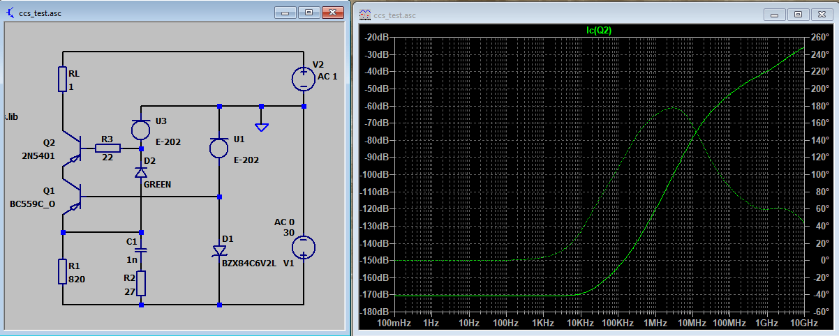

Constant current source for LTP - need help with LTSpice simulation
D3 should be referenced to emitter of Q1. And yes, replace resistors with current sources.
