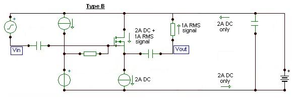

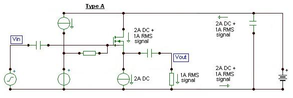

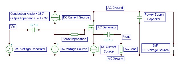

OOpsie, my bad, 2'nd circuit should be positive earth as shown below. Sorry, drew it wrong the first time. 😱Godfrey,
I believe that once you couple a signal source to the right hand circuit, you will see that the PS ripple is back into the circuit, big time!
jan didden
As shown below, the 2'nd circuit should have good PSRR etc.
When simulating the circuit.. theres no modulation on the power supply or ground what so ever....I did the same with GND as reference and then there is clear modulation...off course..the current sources in simulation are ideal..with unlimited impedance...but never the less they show quite big difference...so stating that the circuits are the same regardless of where the reference point is for the load..is simply stating something out of thin air...
Still wonder how the dual shunt would perform...

Andrew,
I was about to urge the combatants to differentiate between DC and AC in order to give some sort of meaning to the explanations that I generally find extremely muddy.
No trap. In post #29 I was explicitly referring to constant DC current. Dynamic AC load current is never constant.Wuyit,

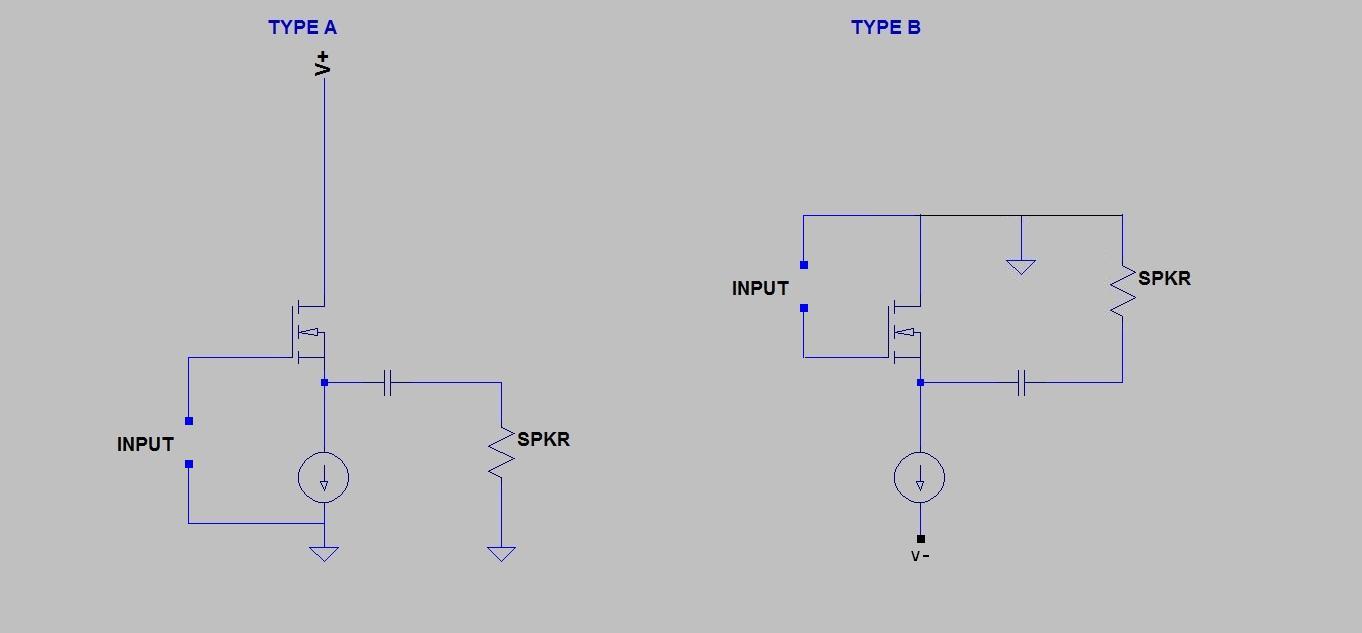

OK,
So it would seem to me the best way to go would be to use a p channel follower. That way the CCS is on top and the speaker can still be connected to ground but current draw will remain constant.
Seems like the obvious all round compromise provided there is no sonic disadvantage to using p channel fets - just started a thread about this.

Yes, that's one way to do it. Alternatively, you can use an n-channel follower, and connect earth to the positive supply rail instead of the negative one. See post 46 for a simplified circuit.OK,
Either way you end up with:
a) Mosfet drain is connected to whichever PSU rail is grounded.
b) CCS is connected to the other PSU rail.
c) Input and output are both referenced to ground.
Ah yes, thank you godfrey. I somehow missed that post. I like it, especially considering the flaws in p channel devices. A much neater solution.
I'm going to rearrange my amplifier circuit to suit. Will post a schematic later.

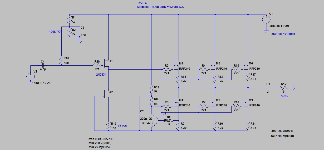

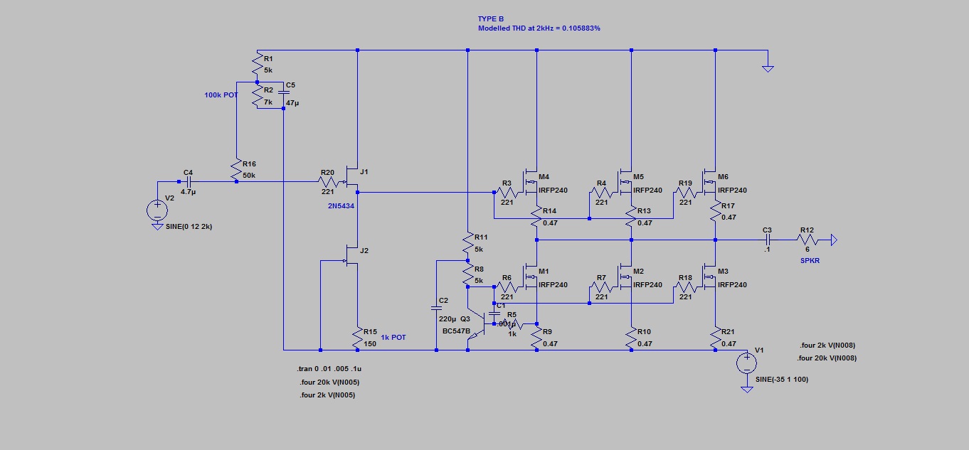

I simmed the two real life circuits shown below. Unexpectedly, with a simulated 1V supply ripple, the distortion improvement in the second design is almost negligible:
TYPE A (1V ripple) Total Harmonic Distortion: 0.108783%
TYPE B (1V ripple) Total Harmonic Distortion: 0.105883%
However, with a 3V ripple things get interesting:
TYPE A (3V ripple) Total Harmonic Distortion: 0.116670%
TYPE B (3V ripple) Total Harmonic Distortion: 0.105884%
You can see that the increase in supply ripple has a much lower affect on type b.
One would assume the difference would be more substantial in real life?
Now, a question for you experienced builders. How much ripple do we typically see in a heavily engineered non regulated PSU for a Class A amp? I think usually under a volt or two? So distortion improvement is probably minimal.
In any case, given the fact that each design is identical in terms of parts count, it would seem prudent to go with type b and be comfortable knowing you have chosen the lowest distortion design possible 🙂

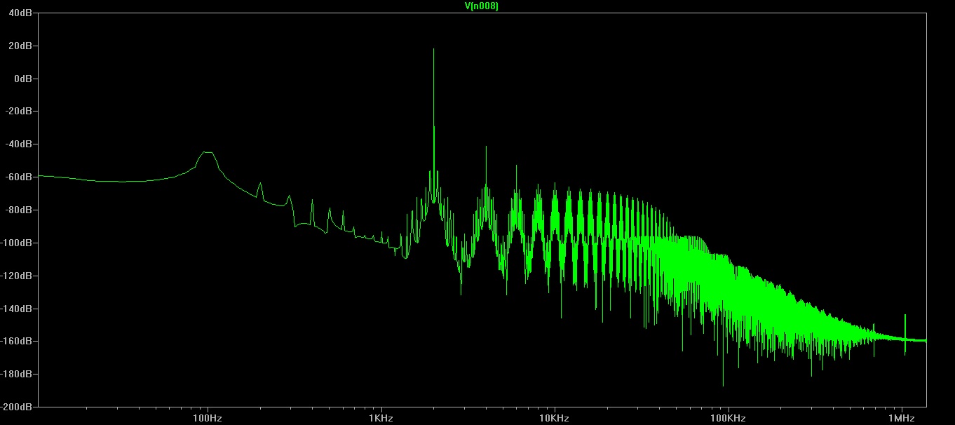

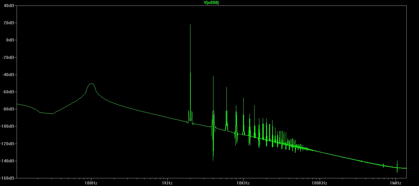

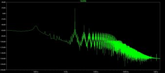

THD, .four is not what you want
PSRR is simply how much of the PS freq is at the output
a measure of "PS rail distortion" would be to look for intermodulation products between the PS ripple frequency and the signal at the output
to do that you need to look at the fft to see +-100 Hz sidebands on your excitation fequency at the output
you will need to run the sim for multiple ripple cycles - with Blackman window 5x is good to fully separate the peaks
(in LTspice its a good idea to add .option plotwinsize=0 to your schematic to turn off compression)

@swordfishy:
Hooray, nice demonstration of the difference! 🙂
btw FFTs are a bitch. To get accurate results, the interval needs to be a whole number of cycles of both the signal waveform and the ripple waveform (and any other input). It looks like you got that right though, with 100mS, 2kHz and 100Hz.
The other thing that screws up results is slow voltage drift during the measurement interval due to capacitors charging or discharging as the circuit's operating point settles. Two ways to fix that:
a) Let the sim settle before the measurement e.g. run the sim for 200mS but only do the FFT on the last 100mS.
b) Replace any large(ish) caps with appropriate voltage sources for the FFT test.

Thanks Godfrey,
Looks like I lucked onto the right simulation interval 🙂 I didn't know that - how do you people figure these things out!?
I think I'm suitably convinced of the difference to alter the design. As I said, the parts count is the same so it would be silly not to reap the benefits, which as far as I can tell are free in all respects.
