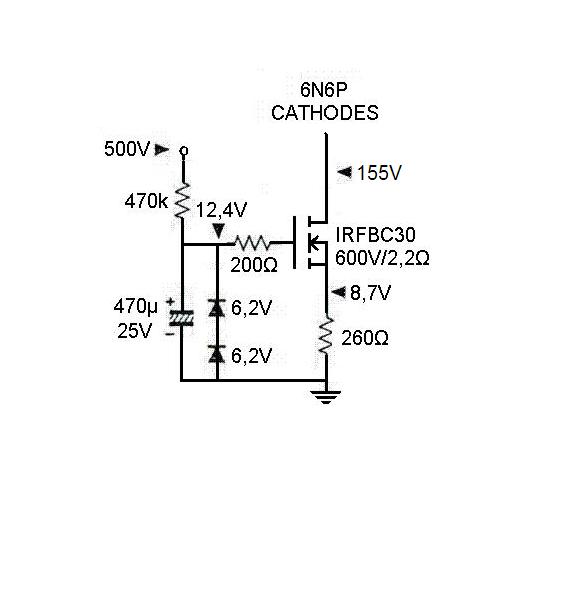

I have been using this for a long time as LTP tail. Very reliable! It could be adjusted to your needs for the mosfet bias and load. Mosfet runs very hot but it doesn't care! Heatsink is required of course. Also the backplate is at the load's voltage (155V in the particular circuit)

What precautions will I need to take w/r/t insulating the MOSFET from the heatsink here? If I understand the tab will be at full HT potential. Will a silicon pad and a shoulder washer (with non-conducting paste, of course) be sufficient?
If you ask about schematic in post #24, I' ve mounted the whole heatsink on a wood surface so it is floated from the metal chassis. The mosfet is straight attached to the heatsink. Not the best implementation but the heatsink is well hiden inside the chassis and I preffered to have the best thermal contact. In my application the mosfet really runs hot as hell...Anyway, if someone who knows better could suggest a proper insulation, I would be interested too!
that should be fine, use the normal creepages and clearances as used on your powersupply. ~4 mm
