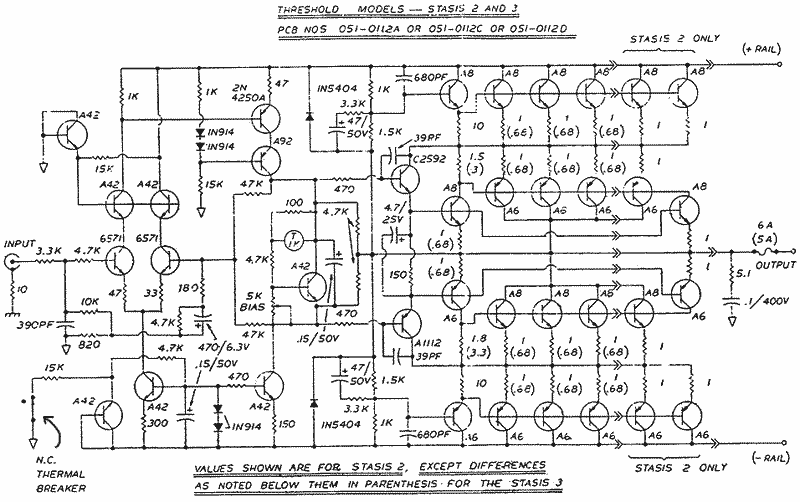

Yes.
See patent 4,107,619 from Nelson Pass. In practice the amplifiers didn't have use an amplkifer 59 in fig 2 of that patent, but a Sziklai output stage. See circuit below.
Steven
Bernhard said:
The driver is the output ? Means Stasis output = constant current and constant voltage ?
Yes.
Steven

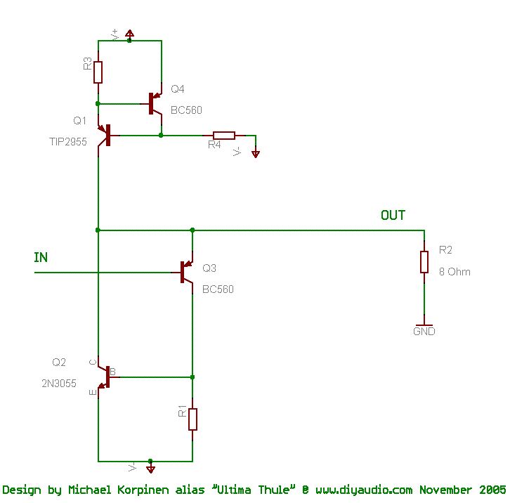

Hi Michael,
You've noticed it! There is a lot of similarity between my circuit and a CFP or Sziklai pair. Actually, my piece of scratch paper where I put the circuit on also contains your alternative circuit, only upside down, with NPN follower and PNP current dumper. Principally, this is the same circuit that is used in the Stasis amplifiers from Nelson Pass.
Only the CFP/Sziklai does not have a constant voltage across the transistor that determines the output voltage. Your Q3 sees big voltage variations and dissipation (temperature) modulation. I know, a floating cascode, connected to the output can solve that, but then your circuit uses as many transistors as mine.
Another advantage of my circuit could be that the current in my output transistor is much larger. Any imperfect current modulation of Q2 (distortion) causes only a small percentage change in current of Q1, so the Vbe of Q1 will be very stable.
In your circuit, imperfections in the current dumper Q2 will cause more fluctuation in the collector current of Q3 and thus more Vbe changes.
Steven
Steven

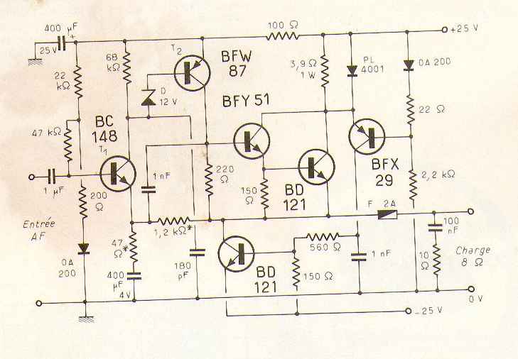

forr said:Not precisely a constant voltage constant current configuration (I suggest you see the Perrot - Lavardin patent where an input device having these features controls an output device in a feedback loop) but an interresting and almost unknown amp configuration : the Taylor's class B amp.
~~~~~~~~~Forr
Hi Forr,
Thank you for showing this circuit from Taylor. It does indeed have some resemblance. Only Taylor's circuit is class AB and it does not make any effort to keep Ic and Vce of the top BD121 constant. I haven't seen this circuit before. Do you know a publication date and magazine?
Steven

STEVEN
"Only Taylor's circuit is class AB and it does not make any effort to keep Ic and Vce of the top BD121 constant. I haven't seen this circuit before. Do you know a publication date and magazine?"
The circuit was first published in Wireless World, june 1973.
I saw it in a french magazine in 1974, I was then unable to understand how it works. I never think of it since albeit solid state amplifiers are one of my main hobbies. It just came back to my mind a few weeks ago, I only remembered the 3.9 Ohm resistor and its diode. I ggogled and got only one reference, so I asked on a french forum if anybody had a copy. I was lucky, there were two responses.
No effort to keep Ic or Vce constant but the similarity with your circuit means your idea should work as a class A amp.
I have done simulations of similar circuits with Tina demo but could not get any satisfyning result
