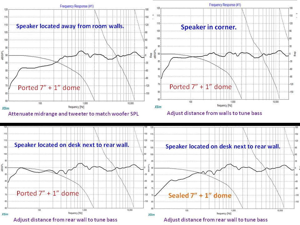

A few on-desk placement SPL sims.

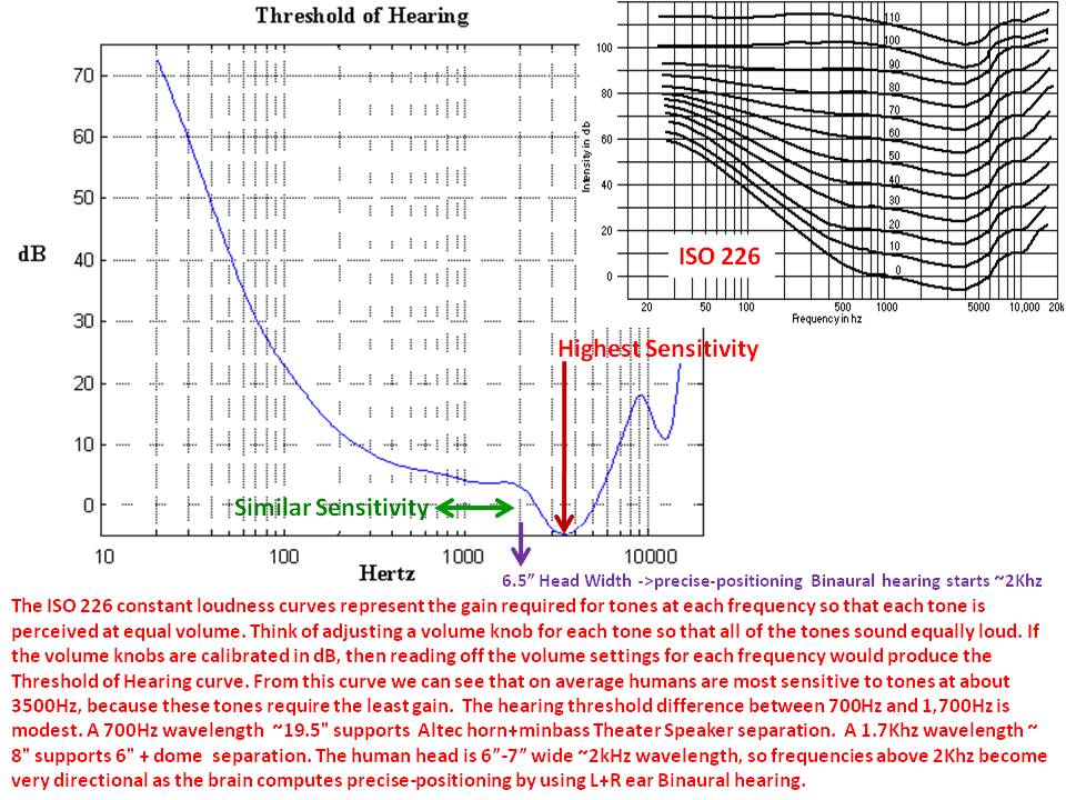

The ISO 226 study of constant loudness curves provides data which supports 1600-1700Hz as desirable for crossover between the midrange and tweeter. Crossovers at higher frequencies move into a high sensitivity range of human hearing, as well as move into wavelengths shorter than the width of a human head where the brain computes precise positioning by using L+R ear Bianural hearing.
Simulation of boundary effects when a 17"H x 10"W x 12.5"D 2-way speaker is located on top of a desk and against a rear wall in a modest volume room illustrates the amount(~5db) of reflected bass energy gain possible. You will not hear the first-edge impact of a bass transient, but you will hear the summation of reflected increase in low frequency energy.
Simulations of locating this speaker on a desk and against(near) the rear wall illustrate good low frequency reproduction from a ported alignment, and fast transient sealed alignment bass with a slow roll-off from F3~70Hz. The 0.75cuft cabinet can support the flexibility of an open bass port, with the option to seal this bass port later.
