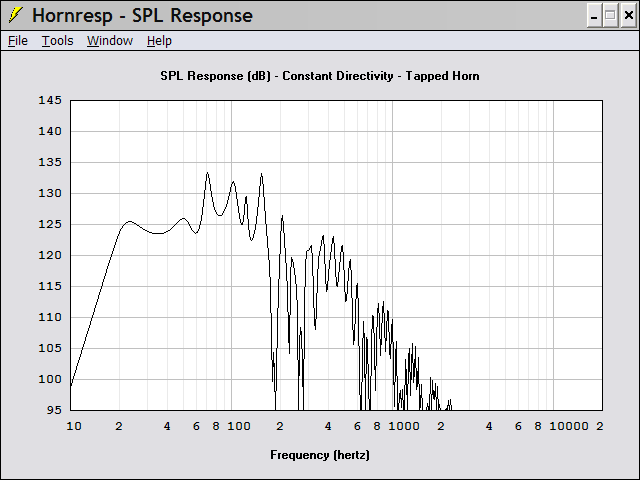

Don't know why, here's a conic quick sim in ~375.6 L corner loaded @ ~100 W:
GM

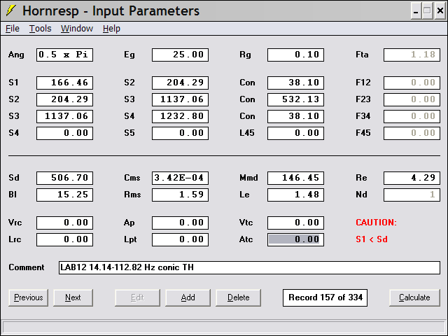

Could I please see the parameter entry screen?
