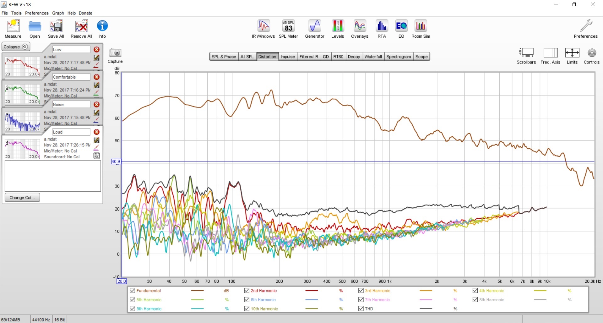

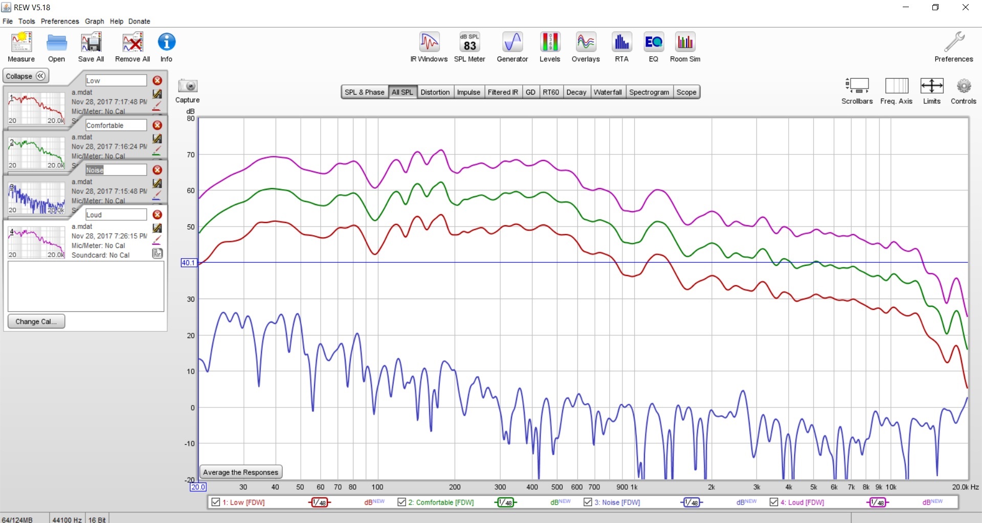

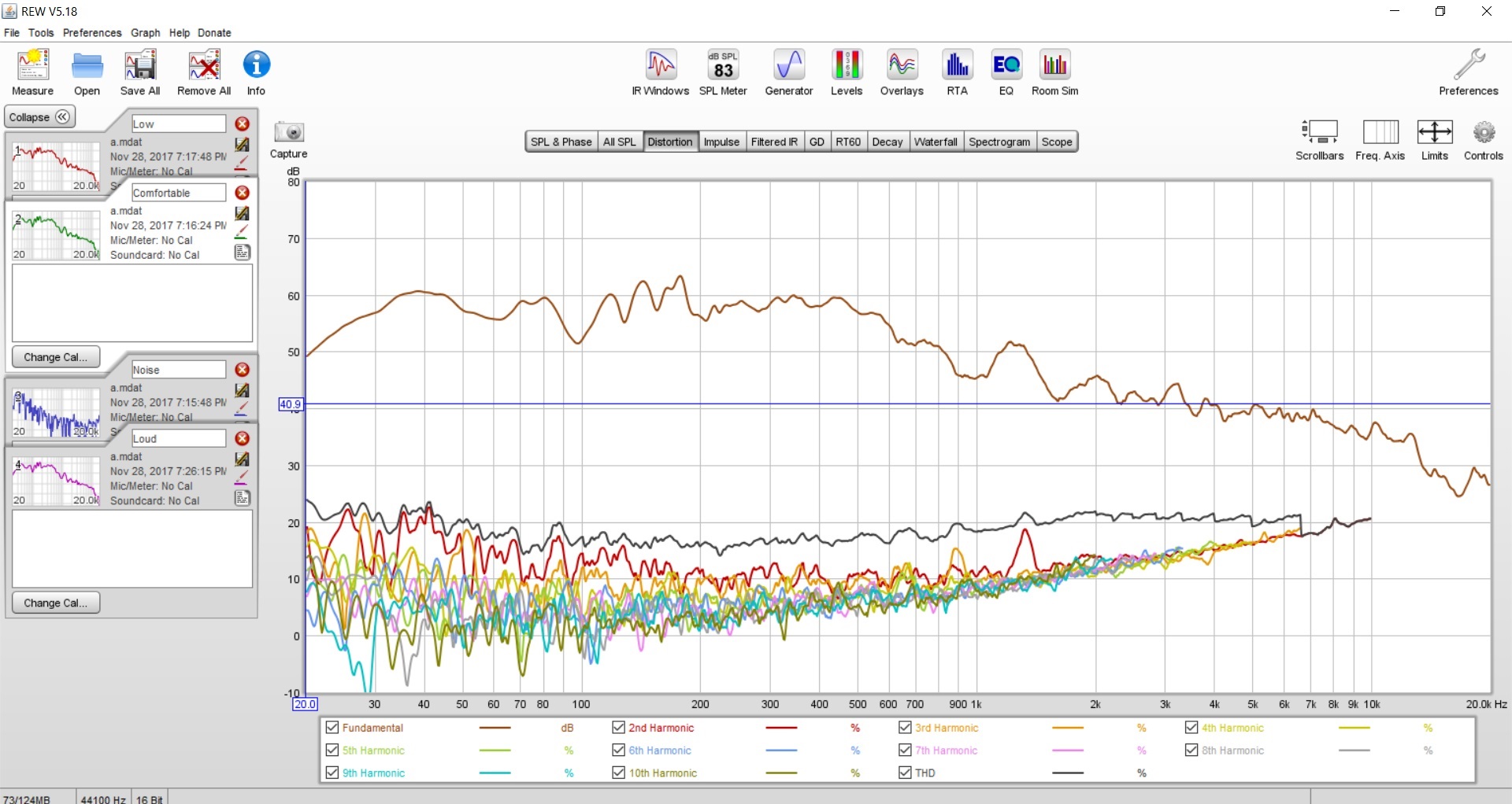

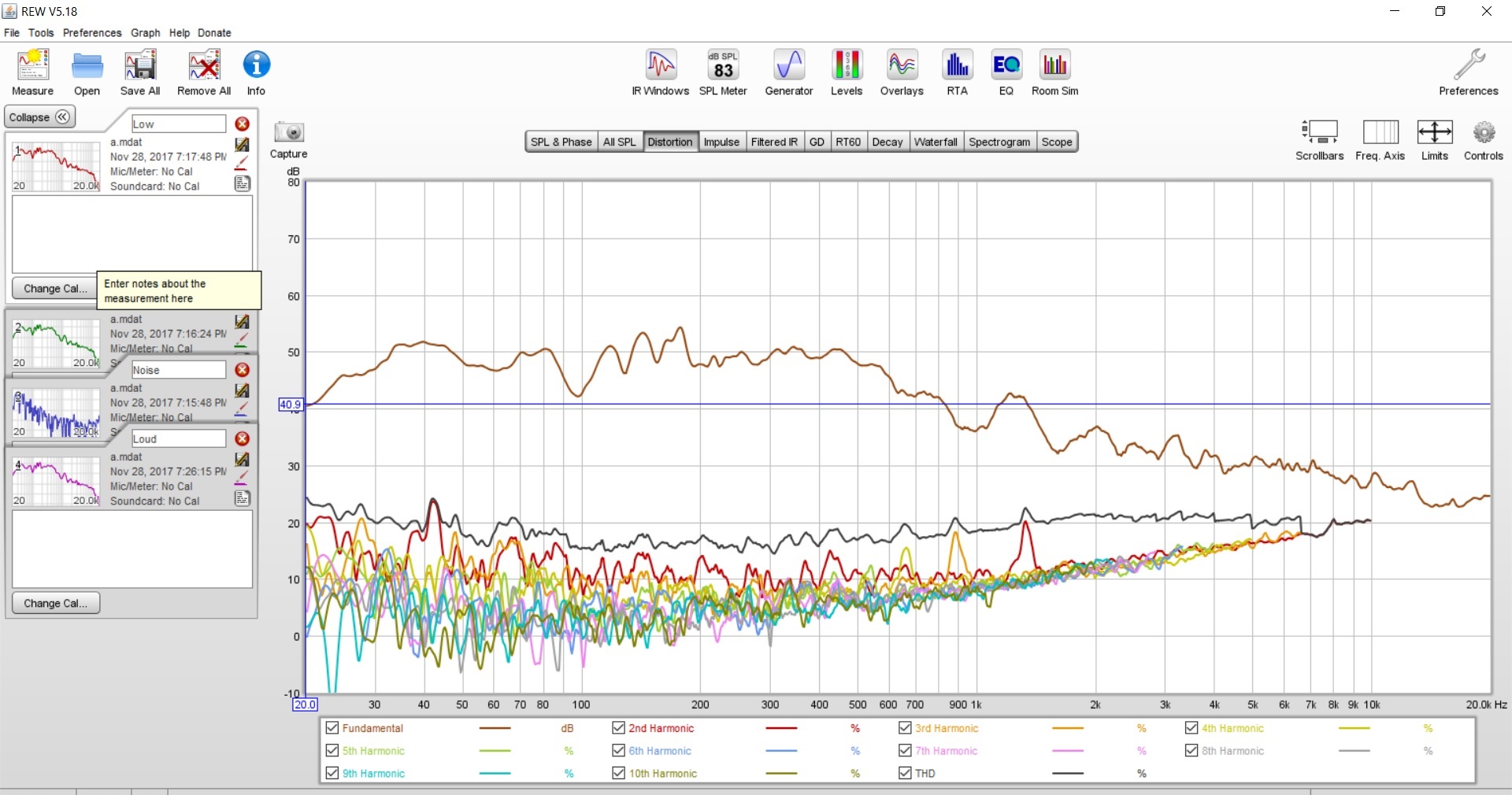

Attached is picture. The mic is about 12 inches from the Left woofer cone. I'm sitting at the couch. This is not Absolute SPL. I wanted to run some other measurements before using REW to calibrate the Level.
The Loud sweep is as loud as I care to take it.
The Comfortable sweep is normal listening.
The Low sweep is ok.
Below that I don't care for the sound. Everything breaks down.
Something going on with the distortion around 100hz when loud but there are some people walking about (inlaws are here).
Not sure what this test shows only have my other setup will not go as low SPL and still sound ok. I'll try to get some absolute SPL numbers for my listening position.
I actually I don't have an SPL meter so I can't do absolute level. Levels were way below rock concert levels.

Right I see. I'll redo the test on another woofer I have here and go lower in volume. Will do less smoothing, maybe it will show up more. Its just time right!!
