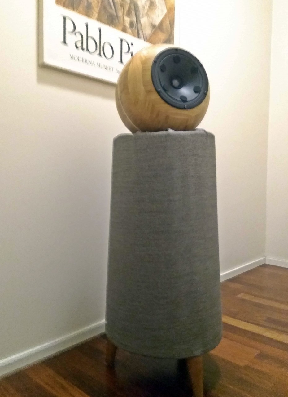

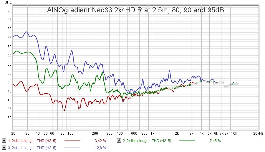

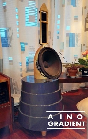

I have two 4-way speakers with SEAS 26LROY subs, sealed downfire. The have been playing almost every day for 9 years now. No signs of sagging or increased distortion. Distortion measurement was taken two days ago with the speaker in same location as in the picture, some of distortion peaks come from furniture resonating. Me happy.

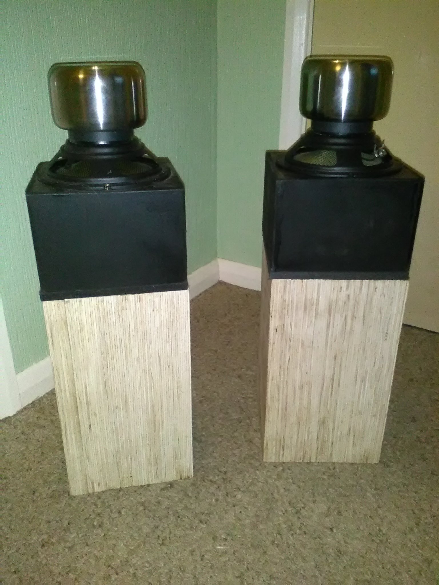

Right, I'm a 'broken record' re the cab has to either be heavy enough to stay planted or add removable mass on top/whatever and this means at least as much as the speaker weighs as a starting point.
If you feel like a broken record, you did so in another thread. That's why I volunteered the information.Right, I'm a 'broken record' re the cab has to either be heavy enough to stay planted or add removable mass on top/whatever and this means at least as much as the speaker weighs as a starting point.

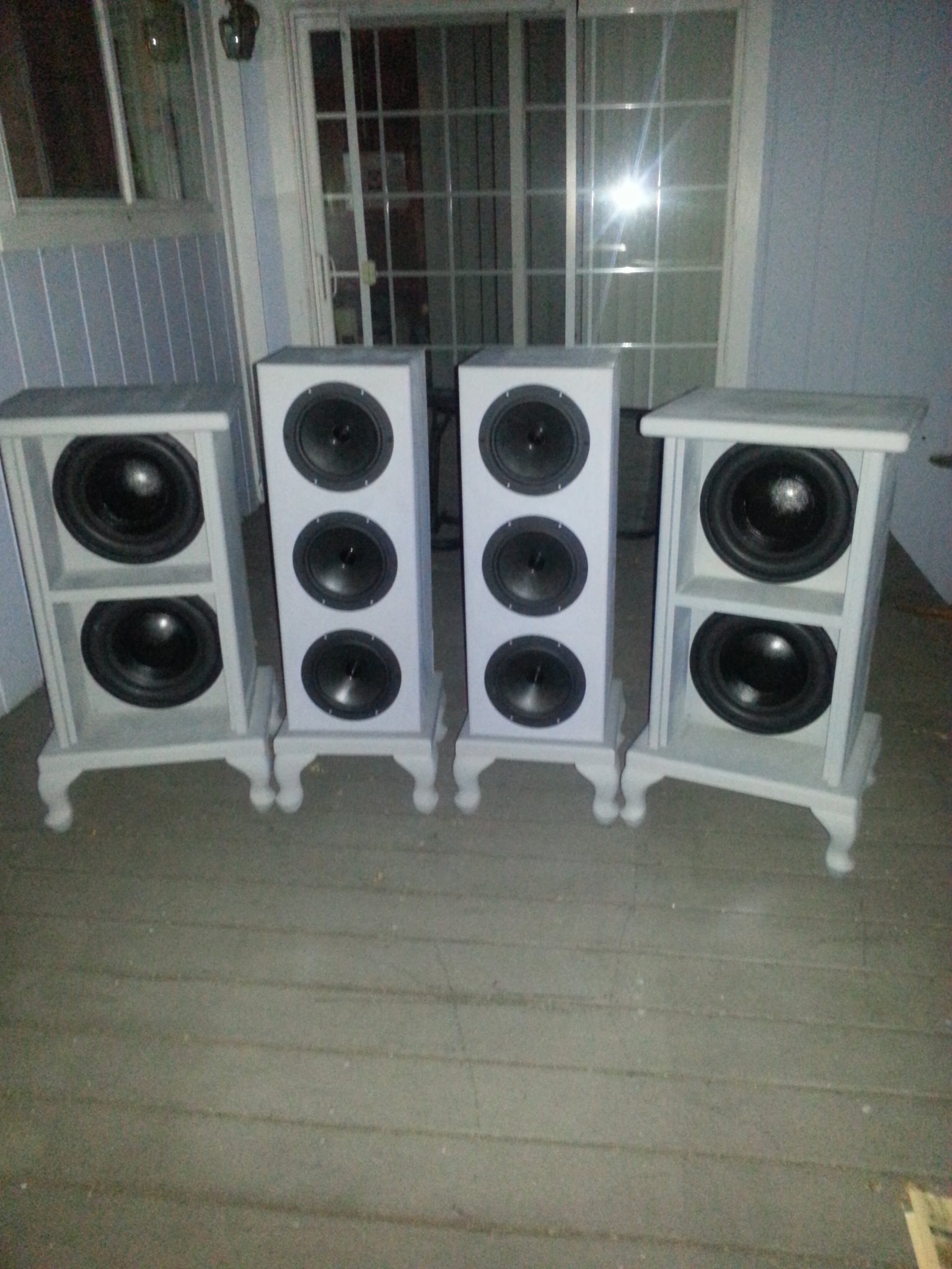

I like GRs and Rythmik subs. I own 3 set of doubles. Wonderful. They are mounted on Queen Ann stubbys. I did the same with bass columns. They are SAT by design. (Stack and Test) The 8" bass columns stack up to 3 modules high. Behringer 12K per column. They are direct coupled with short fat cables. They actually have good cone control with a DCX2496 controller. Rythmik plates for the OB subs. Good flexible bass system. Sure works great with small planars and ribbons.
I'm working on TWO rooms at the same time. I'm dealing with it hip deep so to speak.
Side note: I'm using modded RMx Elixirs with the bass section below or any monitor for that matter. One of those lifetime projects it seems. I'm hardheaded. No downward firing drivers being used though. There are 1.5" BB attached to all the cabinets now. I tried sand pits that worked. What's the point of leg if you can't see them? Stupid physics. 😎
I like seeing legs, even short stubby ones. Turn Tables next.

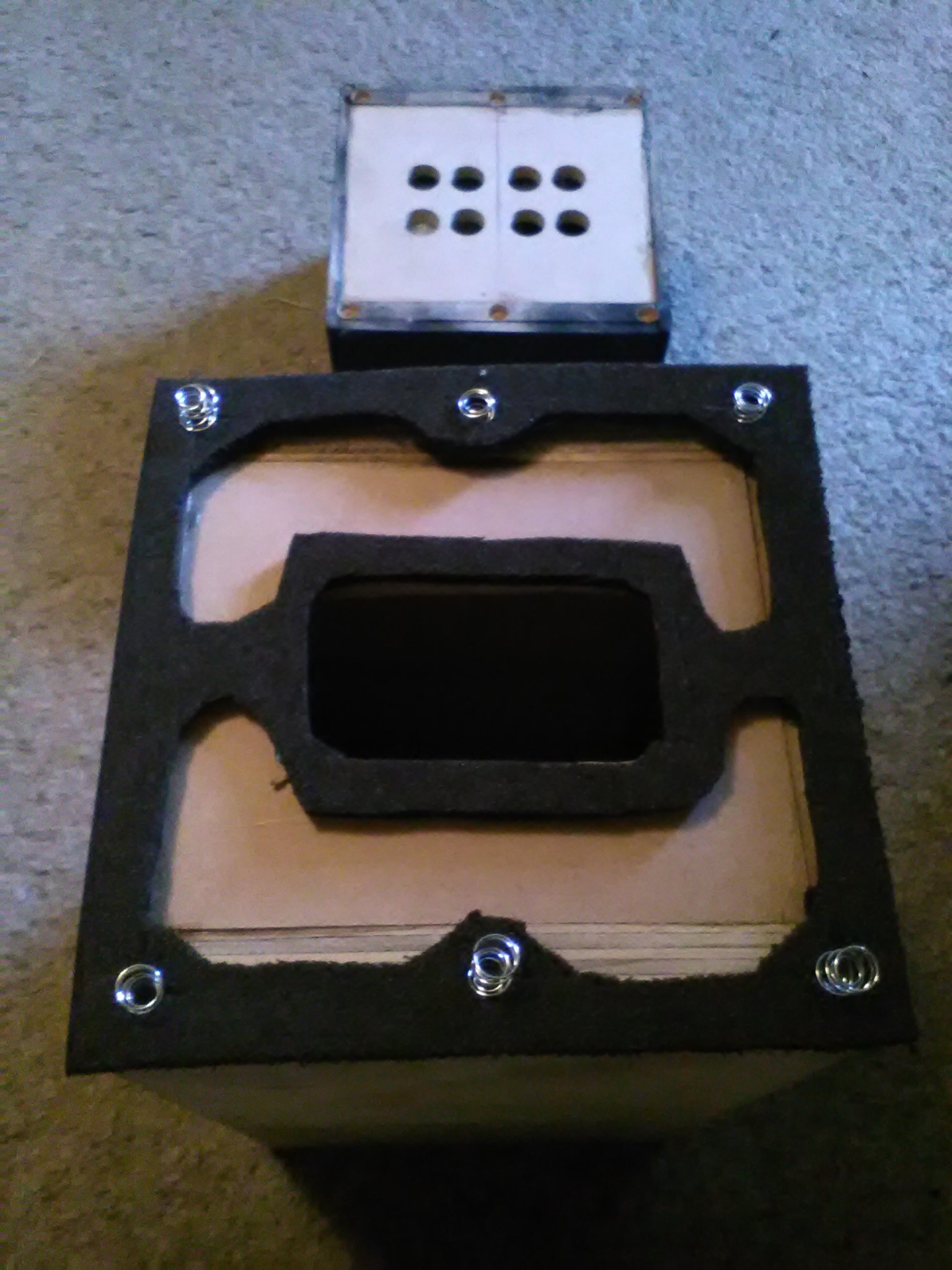

Add a butt plate to the bottom (slot load) the bass driver. It cost 20.00 usd to try. Throw a pillow under the plate after you attach it. Do it to ONE speaker. Use anything, just slightly larger than the legs OD, but enclose the slot and decouple ONE speaker. If you like sound effects for HT, leave it open. 🙂My downfires weigh 42kg. the 10" SEAS can't make them dance. Felt pads on legs.

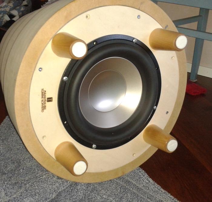

View attachment 1092693 View attachment 1092695
Neither do these, weight 25kg with SB29NRX
