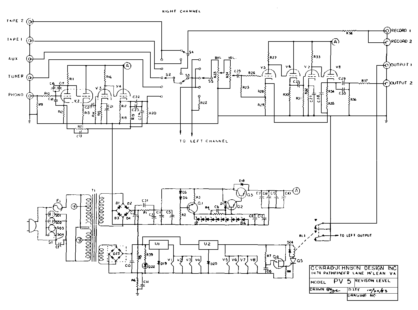

Hello,
since i finished my pass F5 Monos, i need something to drive them properly, i decided to go with the Conrad Johnsons PV-5, since it has enough gain and a phono stage. It will be my first tube project, but i have an oldtimer at hand who will support me, he is building tube amps for over twenty years so i guess I can try a Preamp with Phono Stage.
I have some minor questions on this circuit:
1. What are the transformer secondary voltages / Ampere Ratings?
2. Which of the powersupply transistors (Q1, Q2, Q3) should be heatsinked?
3. What voltage should the regulated power supply have?
4. Where to get 1% Caps for the RIAA Network? Digikey seems to have none left and my Fluke 29 isnt the most accurate in measuring capacity.
I have attached the schematic at the end.
Q3 needs a heatsink, as it's the pass element. If airflow is good, I'm guessing Q1 and Q2 are OK, without heatsinking.
Try Nebraska Surplus. A mix of NOS mica and 'styrene parts should serve you well.

2 problems solved, two remain : The Transformer voltages, I guess one secondary is 12.6V and the current needed can be calculated quick and easy by summing up the heater currents, but i am searching for 3 days now to get the other secondary and voltage for the plate. I even searched old triad transformer catalogues since the part number is given in the parts list but with no success.

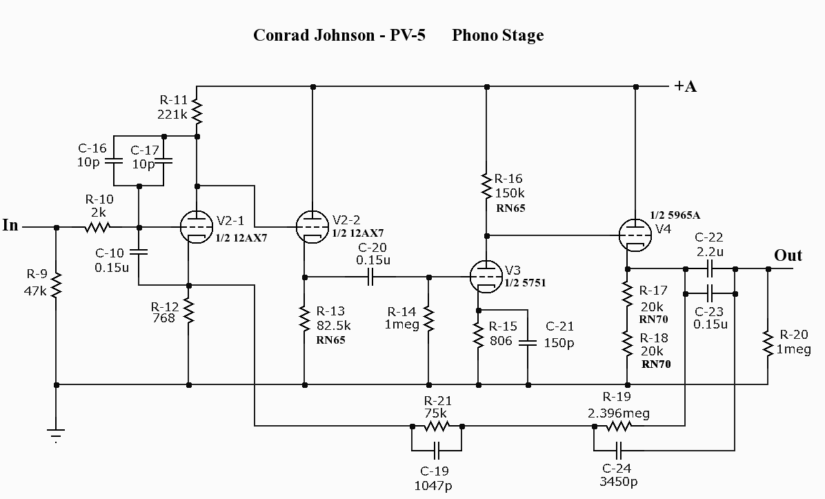

The F5s need about 6V-7V input for full output swing, so i need a total gain of roughly 65dB from the preamp including , 40dB from the phono stage, another 25db from the line stage, I just listen to vinyl so the line stage is only needed to amplify the phono section, no high level sources here.
I know passive EQ is hip at the moment... but ... well there are many good sounding active EQ circuits out there too.
I just obtained the schematics of the premier 3, including all node voltages, might give it a try, but it think ill have to get some sleep first and think this over again.

I need : 65db-70db gain, MM compatibility, Riaa Accuracy +/- 0.2dB, proven design with easy to source parts, pre and linestage using the same power supply and a knob to control the volume and low distorsion (below 0.1 or better) since my speakers are not really effective (89dB) and output should be phase correct and contain absolutely no DC since F5s are direct coupled.

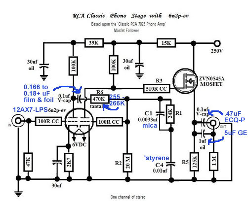

RB,
The tweaked RCA circuit yields approx. 45 dB. of gain. You can easily get the remaining 20 dB. from a resistively loaded common cathode ECC99 section. What's the I/P impedance of a F5?
That sounds interesting, tell me more. The Circuit looks really nice, what about RIAA accuracy

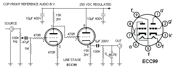

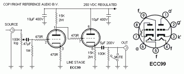

P.S: Just found this simple linestage with the ECC99, but no gain is mentioned
RIAA accuracy is good. If you are fanatic, use plastic film, adjustable caps., as shown here, in the EQ network, to achieve "perfection".
Do you have a link to some example schematics for the ECC99, this could mean i can get a fully functional preamp with just 3-4 tubes, if the output phase is correct and not inverted, i am in.
Common cathode cathode topology inverts absolute polarity. So, constant current source (CCS) load each ECC99 section and cap. couple the plates to transformers, which allows you to make the line section non-inverting, end to end. The MagneQuest model B7-10K:10K seems suitable. The step down B7 models are also interesting. You may be able to get something suitable from Sowter in England, which is closer to home.
But isnt the Mosfet of the MM Pre a source follower and inverts the signal, this is fed to the first half of the ECC99 which is non inverting and the last ECC99 is a cathode follower which inverts the already inverted signal and in the end i have a nice noninverted signal.
I dont mind to have inverting and noninverting stages mixed as long as its noninverted in the end.

All (cathode, source, and emitter) voltage followers are non-inverting. The tweaked RCA circuit has 2X inverting (common cathode) gain stages and a non-inverting source follower. So, absolute polarity is retained, end to end.

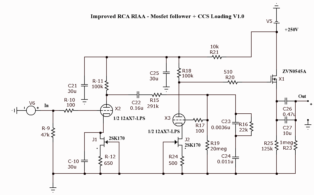

I found out that i used the wrong 12AX7 models for the spice simulation, had to use the ones with grid current, suddenly all simulations became somewhat more realistic.
I modeled the improved RCA circuit you posted to fiddle around with the RIAA values a little, well what can i say, i got it to under +/- 0.1db accuracy so i am pretty sure +/- 0.2db can be achieved with 1% parts and a little value tweaking.
What bothers me is : In the simulation (6mv p-p input) THD is around 0.75% and IHD (mostly second harmonics) is 0.64% is this a realistic figure, any way to improve the distorsion charachteristics? I tried around a little with negative feedback and differrent plate resistor values but got little to none improvement.

First of all i want to say thank you for all of you supporting me and pointing me to the right direction, especially you Eli.
It seems that i made a little a little mistake while simulating the THD, i have only run the simulation for 5 cycles = 5ms, but in this time the coupling cap is still charging. I extended the simulation to 100 cycles, THD is now 0.064%.
I also added CCS Loading with jfets to both tubes since i read lots of positive things about it, nothing fancy just a jfets + resistor.
The new schematic is attached, could you have a look at it if everything is ok?

RB,
That schematic is dead wrong. If you want to CCS load the 2nd gain block, replace R18 with a CCS set at 900 μA. Cascoded DN2540N3s should do nicely. I'd leave the 1st gain block exactly as RCA set it up, towards the end of the 1940s. 😉 The FETs under the cathodes must go.
Constant current devices (sources and sinks) are used to replace load and tail resistors.

You don't want CCS in the cathodes of those tubes- quite the opposite, you want to have a constant voltage. You have the first stage cathode bypassed (though you may want to check that value) but not the second. Needless complication- use bypassed resistors or diodes. Calculate carefully the output impedance of the first stage, since the RIAA equalization will depend on it.
The second stage could use a CCS in the plate to linearize it a bit. That's probably the dominant distortion source.

Well maybe i have been playing to much with jfets in the last month, tubes are still new land for me. So back to the original posted schematics it is. After simulating 100 cycles on the original circuit THD is much lower then 0.75% ao will so the safe route and build is as recomended.
The one big problem i have left is the following : i have two 12ax7 models (both from duncans site) but they behave quite different and i must use completely different RIIA values to get the curve right. The questions is : which model to trust?
30uF is suggested in the original schematicYou have the first stage cathode bypassed (though you may want to check that value)
