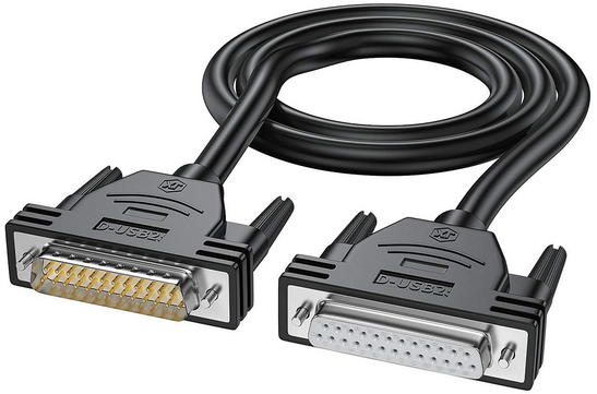

Connection cable wanted to connect meridan C 207 unit A to unit B . I am located in USA northern Virginia . If some one had this cable or know a place to purchase it , I will be very grateful for your help . Thanks . Ali
Thanks for info I purchased the cable happy that pre amp works great but the cd section doesn’t work . The cd spins , laser moves up and down and there is red led light in the laser lens but that’s about it , the cd door open and closes ok . Any kind help to fix it will be appreciated . Thanks
