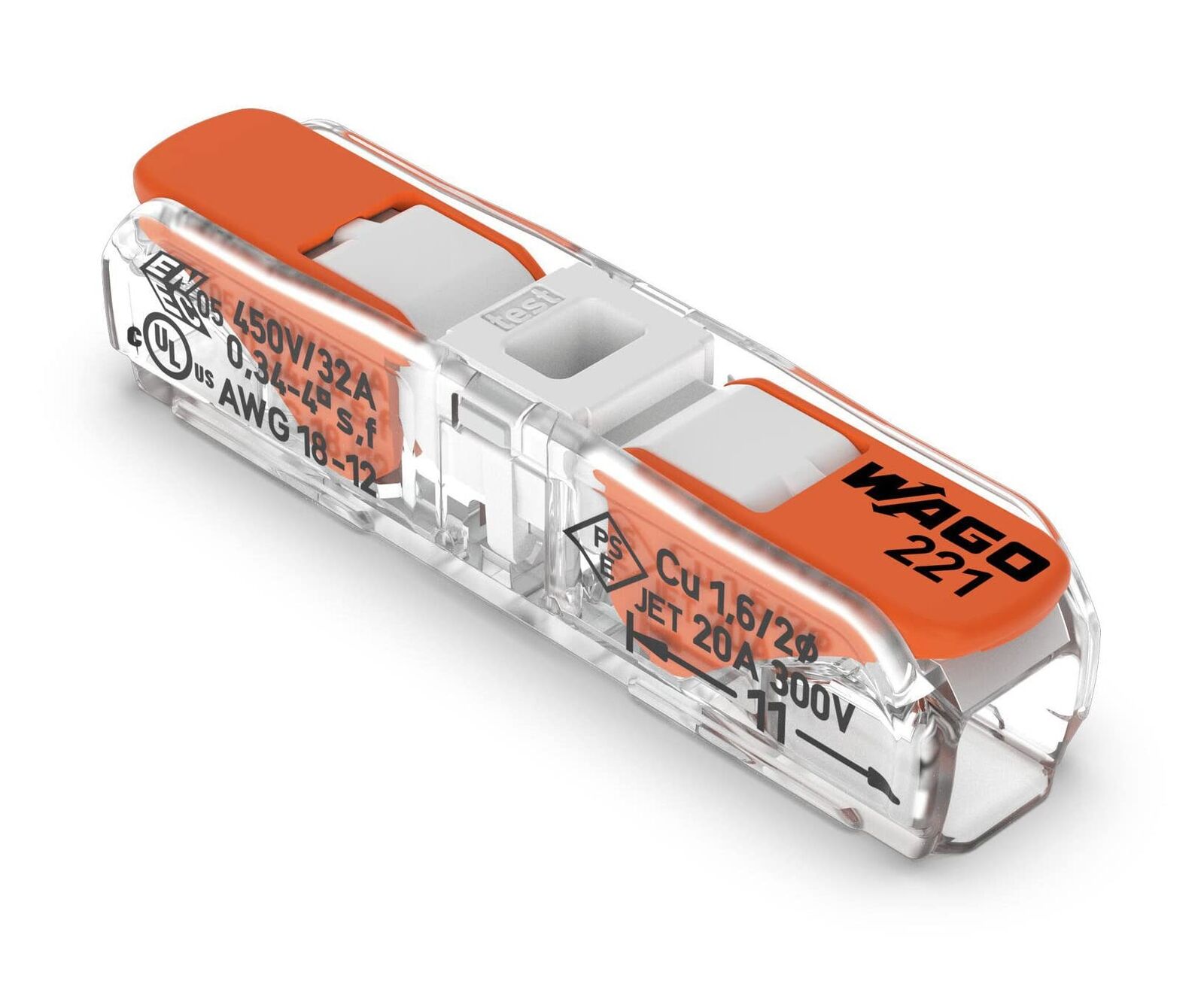

I use them fairly extensively for work and play. That line, 221-4xx is UL listed for up to 20A (a 12ga wire is NEC rated at 20A) and can accommodate solid, strand and fine strand. The 221-6xx are good for 10ga-20ga @ 30A (NEC 10ga/30A). Both current ratings are higher in the CE approval.Has anyone tried these splices?

Has anyone tried these? They should allow for a very solid connection with good compression of stranded wire.They are made in Switzerland, the contacts are copper and they are considered high quality. Why would you not use them for speaker leads?
If your wire is fine strand, a screw lug is less than desirable unless it uses a pressure plate. I generally see those splices used for solid conductors or stranded thhn/thwn which uses much heavier strands and is less prone to strand breakage and settling after tightening. The marine electrical field uses a lot of fine strand and crimp lugs are the preferred methodology. Where FStrd is used under a bare screw terminal, ferrules are generally used
It does seem like wire nuts would work. They can be tightly screwed onto the wires, compressing them tightly together, using pliersSo, common electrician's twist caps, properly sized, aren't good?
It also seems that wires spliced, in crimp and mechanical splices I've seen, don't contact each other. Based on that it would seem that, if a simple disconnect capability is desired, a wire nut might be the best connection because the two wires are twisted/forced into intimate contact. If one spent the $$ for pure or OFHC wire, the benefit might be partially lost because the wires are not touching each other, and the copper splice material is very likely not pure or OFHC copper. I realize that wire nuts in an audio system don't look good, but my wire nut splices will be hidden in an enclose bench. Any thoughts on that would be appreciated.
Thanks for the input but there is just so much snake oil about everything related to audio. I just believe that two wires tightly twisted a in wire nut would allow the signal to pass without interruption. I actually think that maybe the wires without solder but in compressed connection might be better. Any electrical experts' comments would be greatly appreciated.
Electrically it is, assuming it's done well (that last being the potential heffalump in the room), which is why several of us favour them, but except in some fairly extreme conditions, it's not going to be audible. Soldering & sleeving as Chris etc. advocate should be fine & it really comes down to which you feel you can implement most effectively / conveniently & will if necessary provide you with the best mechanical integrity in-use. FWIW, as far as the latter goes, wire-wrap was always considered the optimum by the British military & defence contractors and was used exclusively for connections on wire-guided missiles back in the early '70s as nothing else was sufficiently reliable. However, that's a rather different set of conditions (hopefully!

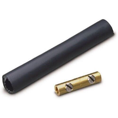

These are pretty fool proof. After assembly, you could wrap with some rubber, then vinyl electrical tape, to seal the connection.
https://www.mscdirect.com/product/details/43597939
A little less convenient, but better for larger gauge wire: (the above wrapping of tapes is mandatory in this case).
https://www.mscdirect.com/product/details/29229242

I thank all for the many replies. Now some have said I shouldn't splice two runs of speaker wires, and just run full lengths from the amp binding posts to the speaker binding posts.
But wires running from an amp to a speaker are made up of many splices/connections, and the results can be excellent. In fact, wires inside the amp are soldered/connected to the amp binding posts. Then wires run from the amp binding posts to the speaker binding posts (more splices/connections). Then the wires run from the speaker binding posts to the crossover, where there are more splices/connections. Then the crossover outputs are wired to the individual drivers in the enclosure, and the result can be excellent sound reproduction. It seems counter intuitive that one more splice will undo the resultant sound reproduction. Any thoughts will be appreciated.
This was meant as a rhetorical question. I've spliced speaker cables and not given it a second thought. Twisting corroded ends together can only be a temporary solution.Are you up on good joint/soldering practices?
