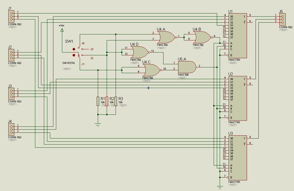

Having two I2S sources, namely Amanero asynchronous USB-to-I2S and S/PDIF transceiver WM8805, and a dual differential WM8471 DAC.
Regarding the SCK, SD and WS lines swichting can be as simple as this:
But what to do with the MCK (clock) lines? The Amanero has a 24.576 MHz clock, the WM8805 derives it's frequencies from a 12.00 MHz clock. Do I have to switch both the MCK lines as well? If so, will a MUX suffice?

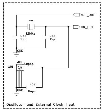

Zsolt, thank you for your answer. Regards the 12.00 MHz clock on the WM8805 have a look at this excerpt of the WM8805 evaluation board schematic:
Seems like the 8805 derives any needed frequency from that 12.00 MHz clock ...

The diagram you shown is for external clock input. I just ran through WM8805 datasheet but I think it uses this input (10-27MHz) to generate through its internal PLL a correct MCLK - so don't think you should care much about it.

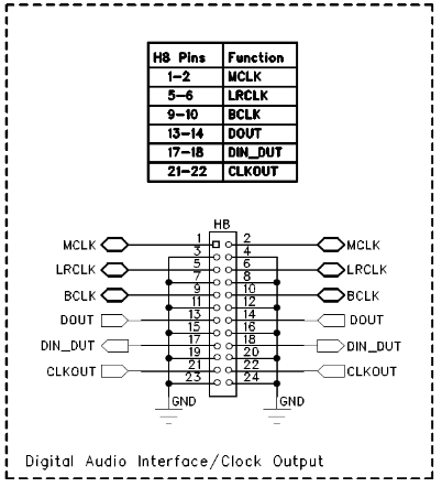

What you should care is the Digital audio interface figure from eval board datasheet: see attached - you have there all I2S signals + MCLK

The WM8805 uses 10-27 MHz clock in software mode only, if I understood the datasheet right. In hardware mode the clock must be 12 Mhz.

I don't feel comfortable with the idea to have the MCK line running through a mutliplexer - propagation delay may (will?) add jitter.

This clock's frequency has nothing to do with output MCLK frequency. Forget about this 12MHz clock. MCLK frequency is generated through WM8805's internal PLL to be relative to the input stream frequency.The WM8805 uses 10-27 MHz clock in software mode only, if I understood the datasheet right. In hardware mode the clock must be 12 Mhz.
If you are using it in hardware mode - WM8805 pg30:
"FREQMODE control is fully automatic to ensure that the MCLK output is maintained at 256fs relative
to the S/PDIF received sample rate.
In hardware mode, the OSCCLK must be 12MHz and hence the external crystal (or applied XIN clock) must be 12MHz. No other OSCCLK frequencies are supported in hardware mode"
Don't have to. Simply use H8 output - you have there all I2S lines (incl. MCLK) - and forget about the 12MHz clock.I'm beginning to think about a possible alternative to the WM8805 ...
No, propagation delay is not same with jitter. Somewhere on the forum were discussing (was also a table) about jitter added by different flip-flops... don't remember exact numbers but it was irrelevant (<1ps if I remember well). Ask Otto II designer, he might know - also he might recommend you a good multiplexer (maybe VHC or AHC series)I don't feel comfortable with the idea to have the MCK line running through a mutliplexer - propagation delay may (will?) add jitter.
You could also use impedance matched RF relays, but you must design a proper PCB for it otherwise is meaningless.

Meanwhile I've found a appropriate MUX: SN74CB3Q3257
Now I have to learn how I get such a doo-hickey working. Switching it with a pushbutton (momentary switch) an having a LED signalling
the chosen input lines would be great ...
