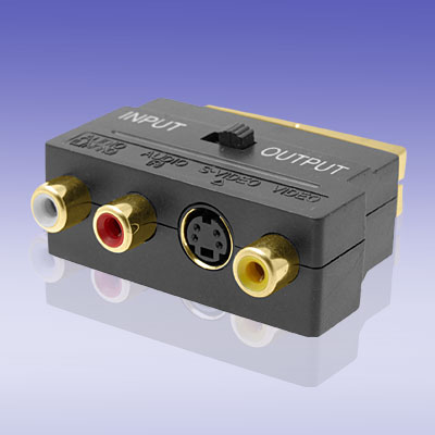

I am considering buying a digital (LCD) TV which has only an optical digital output & no other analogue audio outs what so ever apart from a solitary headphone o/p. I'd like to connect it to my old analogue hi-fi amp line input,which obviously doesn't have any digital connections at all.

Could anyone please give me any idea as to how I can get analogue audio signals to my amp line i/p without using a DAC or is it impossible?

UH no. But if you look on ebay you can get converters for 50 bucks new.
headphone should be out though...
How/why would you have a headphone in....
You can get a headphone to rca cable for a few bucks. Its just a wire, no electronics involved.
Depending on the actual TV configuration there may be an analogue audio output available on the scart socket. Adaptors are usually inexpensive but you will need to find an adaptor that has audio out. Most scart adaptors are configured as audio in, to allow connection of games consoles to your TV for instance. The adaptor I'm thinking of has an in/out switch like this one that I shamelessly copied the photo off ebay!

I was actually thinking of connecting through the headphone outs...but was just curious if a better method could be achieved as cheaply as this!
r0B & Xoc1 excellent suggestion!this means I'd only have to find a SCART plug which receives audio at the same pins as the SCART socket onthe TV!? Or are these different configurations on some SCARTS? Have no shame...we are all guilty hee..hee
