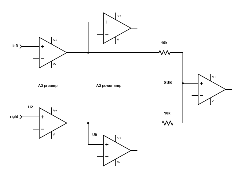

The sub probably has a simple resistor adding circuit to combine the preamp channels into mono.
But this won't affect the main speakers when both of the preamp channels are connected
(as is normally done) to the A3 amp. The preamp's low impedance op amp output shorts out
the other channel that comes through the sub's mixing resistors.
Reactions: Ixnay
Here's a diagram to show an example pf how the other channel signal can bleed through
if one channel is disconnected from the A3 preamp. Of course, the actual circuitry may be different.

Using a multi -tester, the center pins on the pre-outs are shorted. 🙁
You mean when you connect the sub RCAs to the A3 preamp out, the resistance
between the preamp out RCAs is zero?
If so, the sub just shorts the two inputs together. That would be a bad approach to say the least.
If this is the case, you could add an in-line resistor to each preamp out going to the sub, say 10k.
Like in post #8.
Reactions: Ixnay
When i used the connectivity test on the multitester, the tester rang like a doorbell. Resistance is between left and right center pins is 0.5 and 0.9 ohms depending on how hard I insert the probes...
EDIT: Center pins was measured on the pre-amp output of the integrated amp
That is definitely a problem! It should be around 20k or more between center pins on the sub input. You could always use just one channel input and get 3db less output from the sub so just turn up the gain. Low low frequencies are usually monoed out anyway.
If this is true, your amp is playing MONO all the time 🙂
You measured with the amp switched OFF and the muting relay shorted both outputs to ground.
