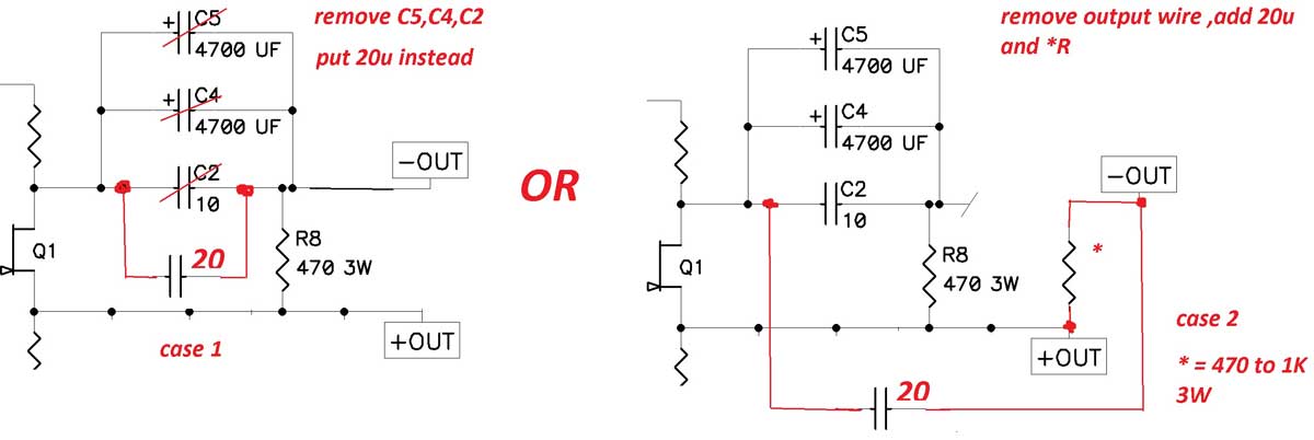

I am using SIT1's to drive JBL2441's with TRUEXTENT diaphragms.
They are used above 500 hz. For a crossover I have 20uF of capacitance in series with the driver.
The 10000 uF of the internal caps and the 20 uF at the driver result in a value just under 20 uF which makes me think why not just place my crossover caps within the amp dispensing with the electrolytics and the CLARITY cap that is bypassing them.
I am not the least bit concerned about harming the value of my amps since I have no intention of ever selling them and have made mods that would preclude an easy sale. The amp will always be used as a 500 hz high pass amplifier.
I have replaced the 4.7 uF input cap with a 0.47 uF VCap which made a worthwhile improvement along with changes to the input and output wiring - better wire using the "select" XLR as the input using only two of the pins, obviously, and Ric Schultz's brilliant idea of bringing the output wires through (drilled) holes in the casing to have both these and the speaker wire clamped by the existing binding posts.
I would greatly appreciate any warnings, other than monetary value ones, as to whether this is an "OK" thing to do. Makes perfect sense to me but then that is why I asking for comments!

two ways of doing that :
-desolder original output caps , replace them with your 20uF cap , leaving output bleeder resistor as is
-desolder just present output wire (isolate loose end) , solder 20uF to SIT drain node (internal output node , pre- output caps) , solder new output wire from it , put new bleeder - 470R/3W across output posts
if you need some sketch , just say
:cheers:

So of course, I like it.
At the moment I am simply replacing the caps just to hear what that does.
I would appreciate a drawing for the COMPLETE (zen) mod.

now to sketch - regarding physical layout- assume that OUT+ and OUT- are actual speaker posts ; rest is self explanatory
in second case , 20u and *R are wired with some extending wires

First impression
Converted one amplifier last night.
I usually will try one channel at a time to make sure all works as expected. In addition, it is interesting to hear before and after together. I have found that the "side" which draws the least attention to itself is the lower distortion one.
The converted amplifier has much less hash/grit intermingled with the sounds we want to hear.
I am using a pair of very large Russian oil/paper caps. They had previously been used at the driver and were the best I had heard at that position. Needless to say I have not compared them to DUELUND's though I wish I could if only I hd a money tree in the backyard.
I completely removed the original caps since that was easy to do. Tonight I will try the the "direct connection" method. I like the idea of getting the signal off of the PCB as soon as possible.
Maybe the electricity was in a good mood last night - could it be that one channel's improvement could make THAT much difference? - maybe I was in the self-satisfied sureness of one's latest modification mode but I heard the best sound quality last night I have ever heard in my house. Can't wait to hear what happens with amp #2 and hope it was not all my imagination. Or the rye whiskey ...
