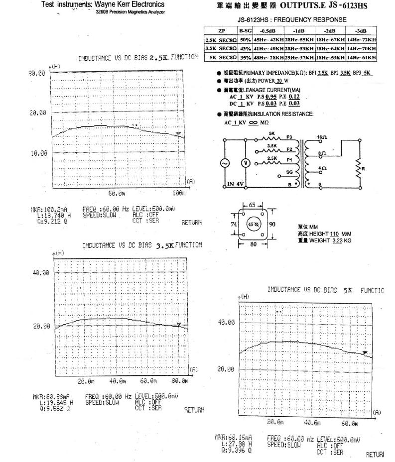

Ryssen Member Joined 2003 2023-08-10 10:17 pm #1 2023-08-10 10:17 pm #1 I have it connected as 3,5k now but want to connected as 5k. I have been searching on the web but cant find any info. rayma Moderator Joined 2011 2023-08-10 10:44 pm #2 2023-08-10 10:44 pm #2 Diagram is here, use P3 instead of P2. Attachments 6123HS.JPG 122.6 KB · Views: 90 Ryssen Member Joined 2003 2023-08-10 11:02 pm #3 2023-08-10 11:02 pm #3 Ok there it was.thank you. You must log in or register to reply here. Share: Facebook X (Twitter) LinkedIn Reddit Pinterest Tumblr WhatsApp Email Link
