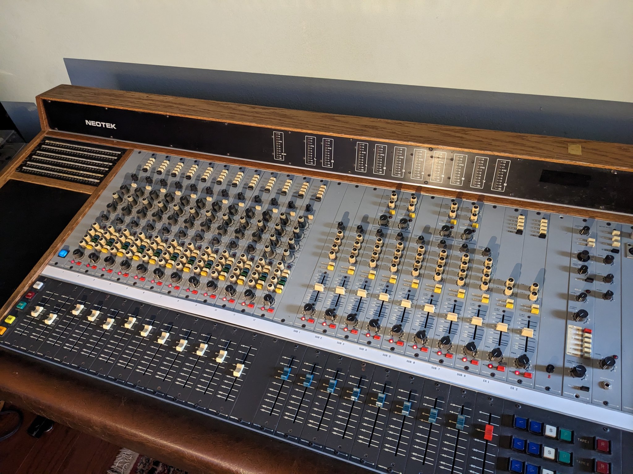

I happened to get my hands on a mostly functional old Neotek mixing board; very grateful to have it.
However the connections are an issue. There are no preamps, which is fine since I have my own, and the only inputs are in a patchbay that was built to accept the old Switchcraft TT-251 jacks, which are unbalanced.

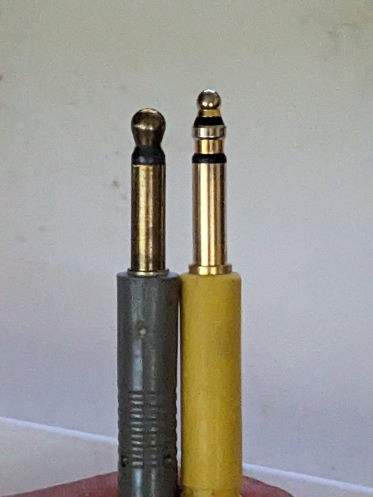

The plug on the left is one of the cables that came with the board and work fine with the patchbay: two conductor, TS (Switchcraft TT-251). On the right is the only type of plug I can find that has XLR's, or 1/4", or RCA on the other end: three conductors, TRS (Bantam TT). 4.4 mm barrels on both.
If you insert the Bantam all the way, all sound is cancelled out. If you go partway, it works, but is obviously not as stable as it should be.

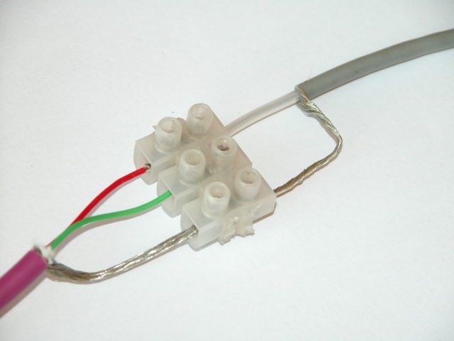

To determine if the cold needs to be grounded try this . Make a test lead cut in two one of your new XLR to bantam cables ( in half if the cable is long enough and you can use the bantam connection later ) and connect to an also cut up TT ended cable using a connector as in the attached photo , so you end up with an XLR ( bal ) to TT ( unbal ) and notice the cold is not connected and try it with signal . Whether this works or not reverse the hot and cold in the connector ( I call it choc block ) and try again this will tell you if the cold is also driven or the hot output is on pin 3 and not pin 2 ( assuming the hot is on the red wire ) or you could/should connect the cold to ground/shield .
