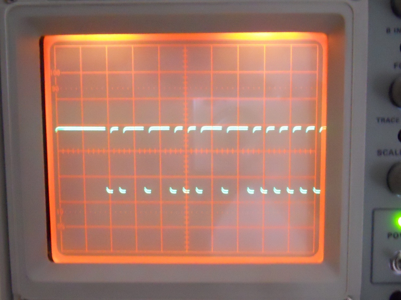

I'll reset the scope to 2V/div and 3ms/div and look see.
1V/div gives a clearer image.
I can't get a steady pattern, but there is a clear ~4V squarewave across the 10k pull up.
quiescent voltage across 10k=0v0.
button pressed gives ~0.7V
This seems to be the biggest and clearest output of the various connection I have tried.

OK... and I can see I must have grabbed the wrong (ch2) probe as it's not compensated correctly for that scope channel. Rise and fall should be crisp.

Got it working.
Yes, it's a module rather than just a opto transistor.
It starts working with 3.5Vdc and in circuit has 5V54 on pin3, pin2 = 0V0
The 10k pull up on pin1 shows a few tenths fewer volts.
Clear codings on pin1 when buttons pressed.
