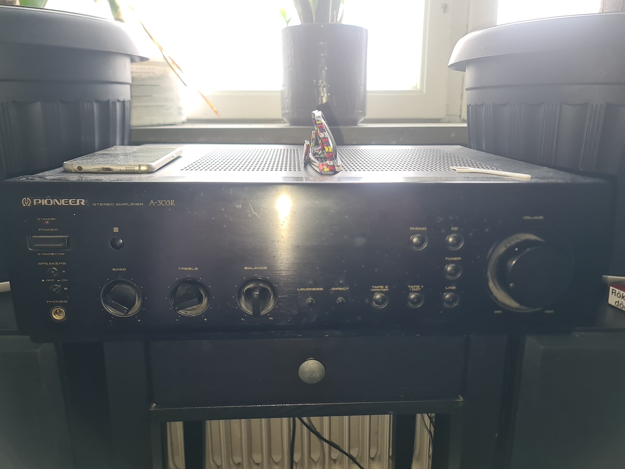

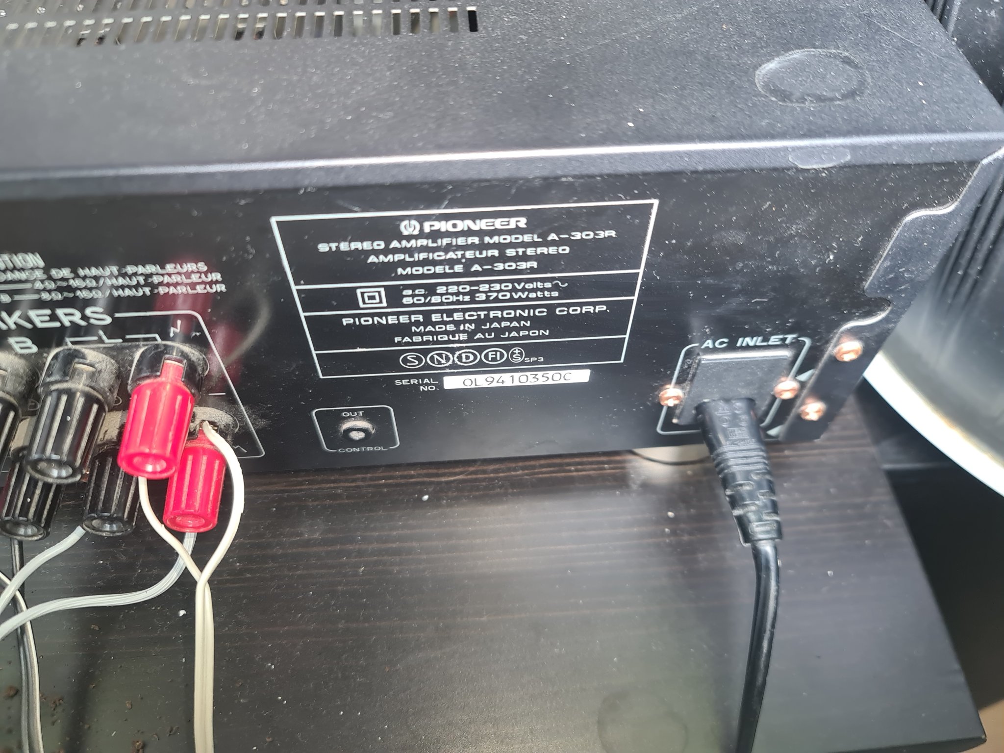

Thanks for fast answer. Im not exactly sure what you mean, I will add a picture and maybe you can explain in laymans terms 😅

You can get line level out of the “REC” outputs, but it’s pre-volume-control. Therefore impractical. Resistive pad off the speaker outs is the only option. This is what a store-bought powered HT subwoofer would do, when connected properly to the speaker outs. Try 2.2K series, 100 ohm shunt. If the sub needs more drive, reduce the 2.2K.
According to the manual listed above, that sub has both High Level Input and Low Level inputs.
So just hook up the speaker terminals of the Pioneer directly to the subs high level inputs using speaker cables.
And you will need a 12 volt power supply to run the sub.
