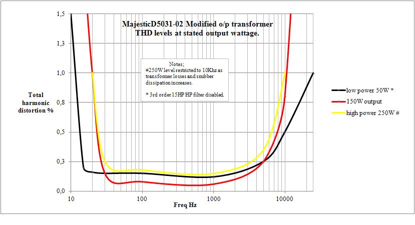

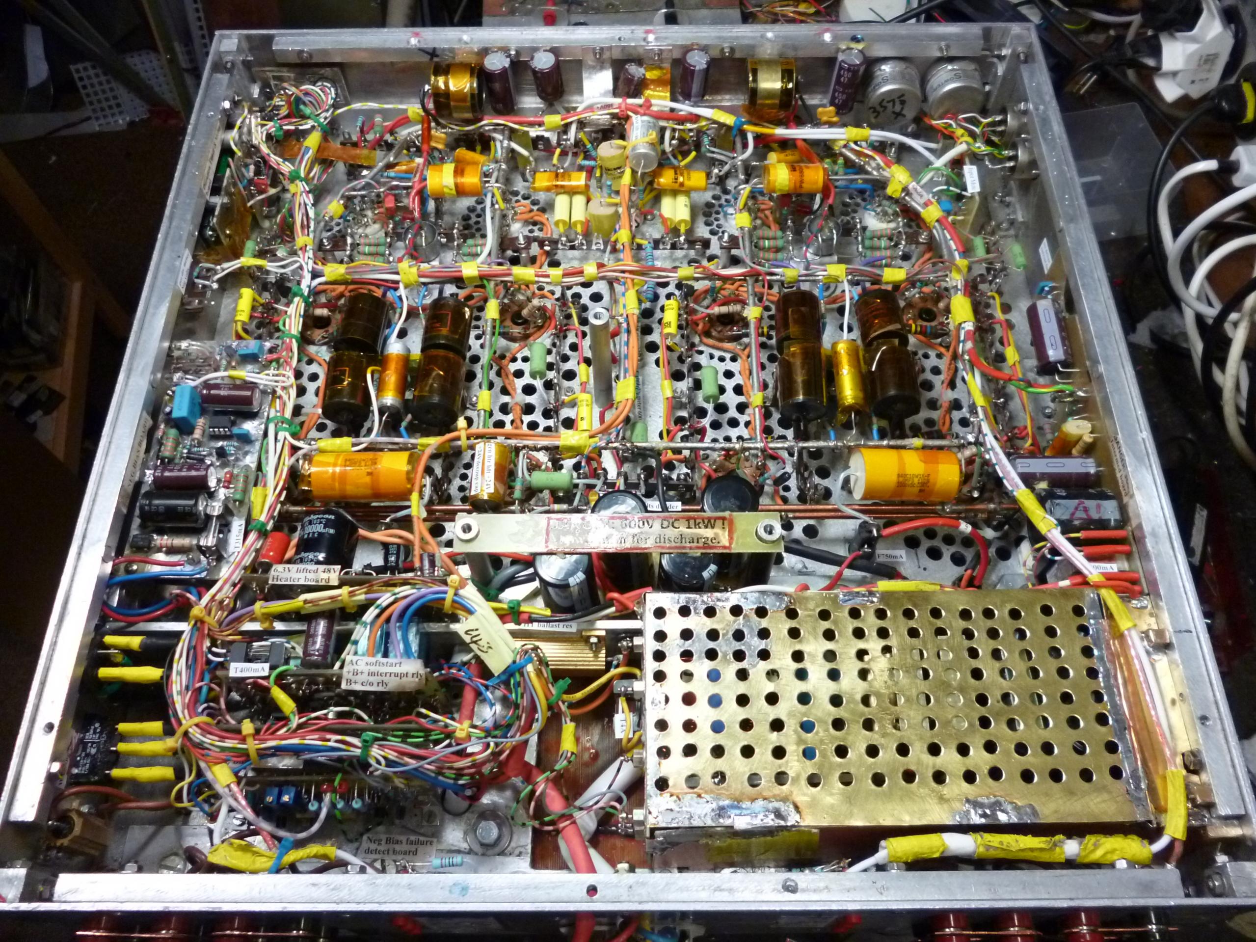

I'm currently revamping the specs; always alterations.... thd stuff encl. The all important phaseshift re-doing. Note the 4mm racket type bus earthing with two thick straps at the upper input end which is the tribute to the performance.This requires a large wattage iron. I used nomex tape over critical components to avoid damaging the thin insulations which is easily done these days...
4 stage B+ for the o/p stage, 200;300;400;600V all selectable A;AB for audio quality; and/or B for MI. I will do a graph of the distortion on this setting.

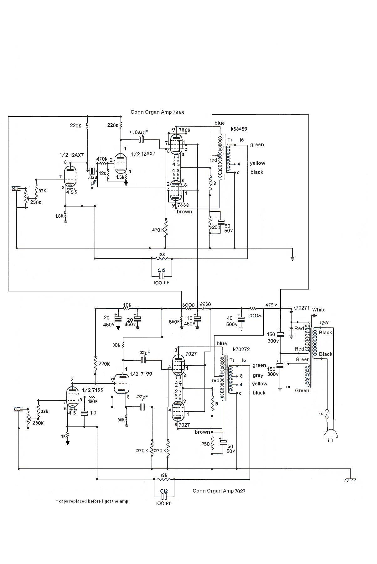

Are you willing to email the schematic for the Conn quad 7868, dual 12AX7-power amp Sir? I kept this one out of the dump. gave away any parts that were reusable so that is the best that I could do. Thank you either way and have a good 2014. Stay Tonal, Tom
I have the quad 7868 amp (free dumpster find). rebuilt it with no schematic. changed all caps and a couple burnt resistors. got a quad of NOS 7868 sylvania's locally for 100.00. this amp sounds amazing. dead quiet and sings like an angel. this is my first tube amp for hi-fi, and has replaced my Luxman M-117 solid state powering Martin Logan Aerius I's. I can't imagine what the fisher 680a that I just got is gonna sound like!
Conn 7868 quad, dual 12AX7 stereo
You have me on edge now! I have only listened to mine with a keyboard. WOW it was clean. I only mod my organ amps very little for guitars. R1,r2, maybe fixed bias. 1m pots for master volume. I rigged a Conn dual 6l6GC- dual12V6 and dual 12AX7s each side. Stripped the "field coil" amp out. Not needed...
Ultra clean at moderate (loud) volume BUT!!! I use in this order stomp boxes-- 1981 DOD 250 OD into a Boss 63' Fender reverb (recent release-best I have found yet) into a 1981Electro-Harmonix Clone Theory to split the single for stereo. The bypass has a little gain there. The DOD does the work for the tone and overdrive.. Man I love the Conn PTP design period. The best. It's ugly but the sound achieved is pure sweet. Kids got a hold of these amps before I could save them, bummer. Saved all parts that I could, give them to friends local. I'm east of LA. I'm getting off thread, sorry folks..
That 12AX7 on the 7868 looks like a modified split tail splitter-really different wiring. drew out the schematic but I have no values!! Mine was in %100 order, all caps just fine, lucky day.
Conn 7868x4, 12AX7x2, stereo
Braet,
You made my week fellow!!!!! It is the correct schematic that I need and then some. I really needed the values for safety, don't want to blow the OPT's or any tubes. Tomorrow I can't wait to study the schematic- compare it to my layout too. I did remod my two bottoms (4x12s") back to 8ohm, previously I wired them 16ohm stereo for another Conn. Anyway, i did plug my Gibson in followed by the DOD250 OD and the clone (2Xoutputs for stereo). WOW this thing sounded great even though there was minimal gain, very minimal. I'm dropping the amp and the preamp into my EPI Valve Special combo box! The hidden amp thing, lol lol. Mount the preamp to the back "door" hinged for access. It's for those jams that others seem to keep cranking theirs up for some stupid reason! The EPI is modded with MM OPT and choke- it screams tone. "OK boys, MY turn." Next is the preamp. Cloned following the EPI, I really love the layout and tone on it. As soon as I have finished this baby, I'll send you a few pix.
