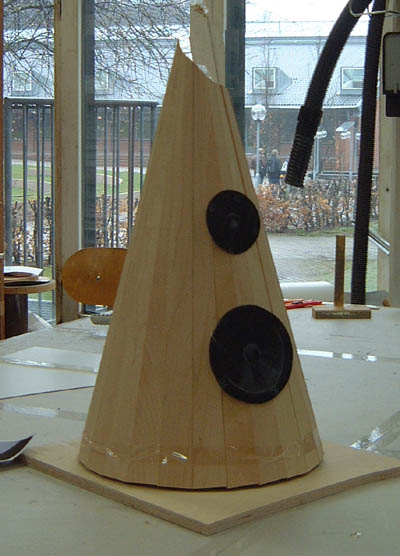

Progress so far:
As of right now I have managed to put one of the speakercones together.
The material thickness is about 2 cm (4/5 in).
My next quest is to trim the top and bottom and build the the "lid"-part on top and the botton. I'll probably use MFD for the bottom since it won't be seen anyway and it's quite stiff.
Still would like to know how to position the elements.
I have also added a picture from the progress in my work...
The elements in the pictures "mockups", just a black sheat of paper in order to try out how different positons visually.

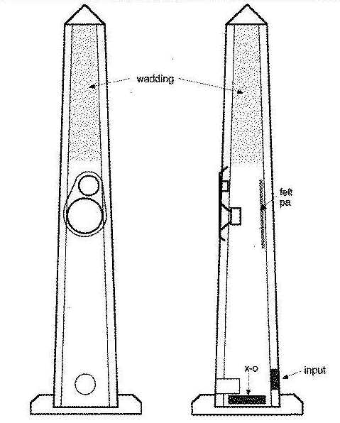

drivers and wadding
The pic above still has the drivers too far apart IMO. Lift the woof an inch or so then lower the tweet to as close as you can get it. Which tweet are you using btw. A beefy tweet with a lower Fs, will allow you to cross slightly lower and maybe use a bit more separation of the woof and tweet if it is necessary for construction purposes.
Now the wadding. This is a normal loudspeaker. is it vented btw?
You will need to treat it as normal and apply wadding to all interior faces. The internal standing waves in this should be fairly well dispersed, so the main purpose of the wadding will be to dampen any cabinet resonances. I would suggest a layer of carpet foam (or similar) glued to the inside then a thin layer of poly wadding. Oh, and if its vented, keep the wadding away from the inner end vent opening by at least 4 if you can.
(the tapered pipe is a different fish completely, which is why the wadding is only at he top in the diagram above)
Have fun !!
The speaker are going to be vented. The pipe will come out in the back, quite far down. The pipe is 48 mm wide (almost 2 in) and 100 mm long (4 in).

more vent length....
My calculations in WINISD and BB6 seem to indicate that what you have at the moment will give you a bass peak in the 60-75 region, not good !! Have you used WIN ISD at all? Its a free download from http://www.linearteam.dk/winisd.html and has your driver in its database. Its pretty easy to use and generally gives pretty good results for bass alignment.
It seems to indicate lengthening the vent to about 180mm. If this is too long, try reducing the radius.
...bass peak
I don't think I can get the speakers much lower than 65 Hz which according to my calculations is what I will get. I am likely to get a muddy sound...

The element will end up sitting quite close together, a bit less than 2 in (4,5 cm) apart....
