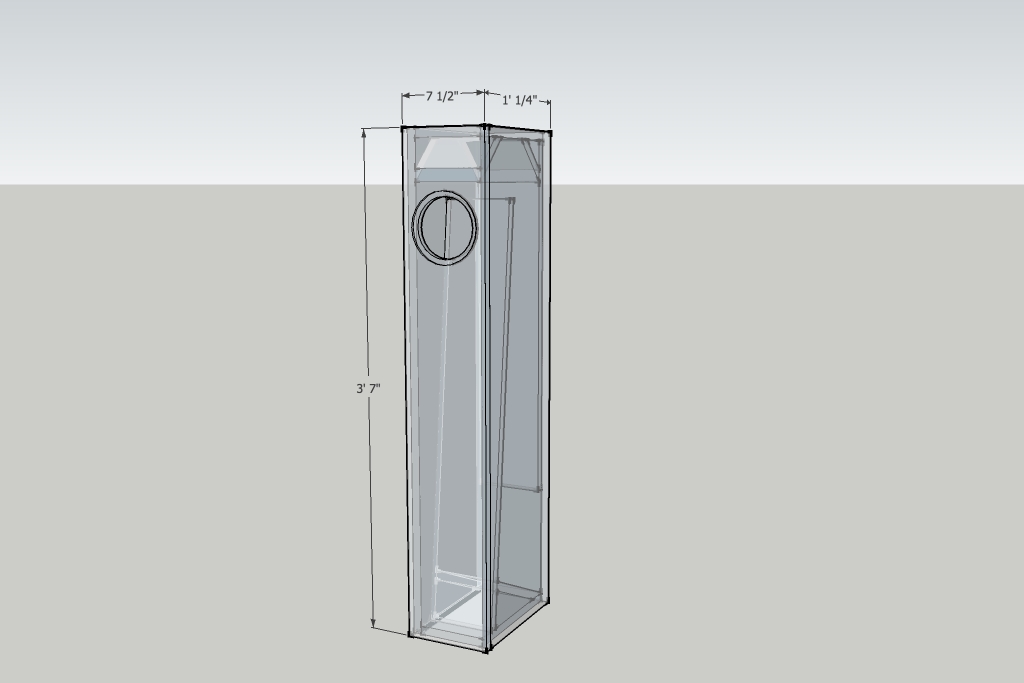

Henkjan (or anyone), am I right to assume that the external width is 190mm and therefore in the plan above the sides are not additional width?

yes, the 190mm is outside width, assuming 18mm thick wood

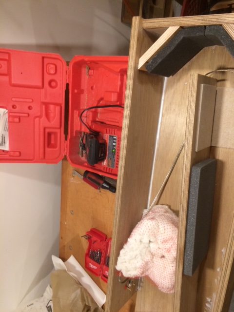

Would acoustic foam like this be an alternative to sonofil for this horn? It seems like acousta-stuf will be very hard to use since it's not made in sheets, and the damping material has to be glued or stapled to the ceiling...
Acoustic Foam 1-1/2" 24" x 18" UL 94
I'm not an expert on horns, but I guess it depends on where the damping material is, if it is "volume damping", so in the middle of the box I would guess it is not a good alternative.
I found no problems with the wool type material, just a few staples of a little glue on the wall is usually enough to keep it in place.

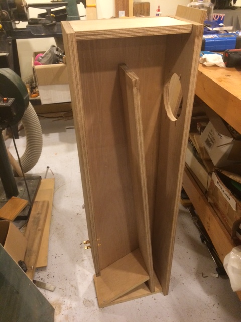

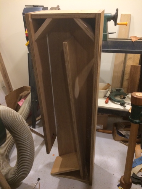

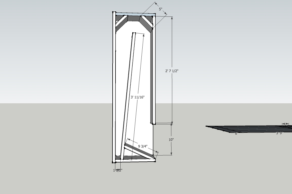

My contribution: a slightly more detailed plan. I changed the measurements to inches and rounded when necessary. I hope they're close enough not to compromise the performance of the horn.

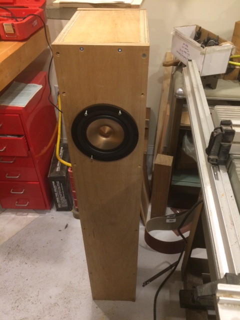

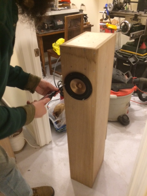

Ridiculus to say after so long but I finished these
I finished these after a long time lapse and I am happy with the result. We are not experienced with wood working and when other issues arose we put things on hold. But we got back to it and finished them. We faked it!!!!
Here are a few pics
Here are a few pics
