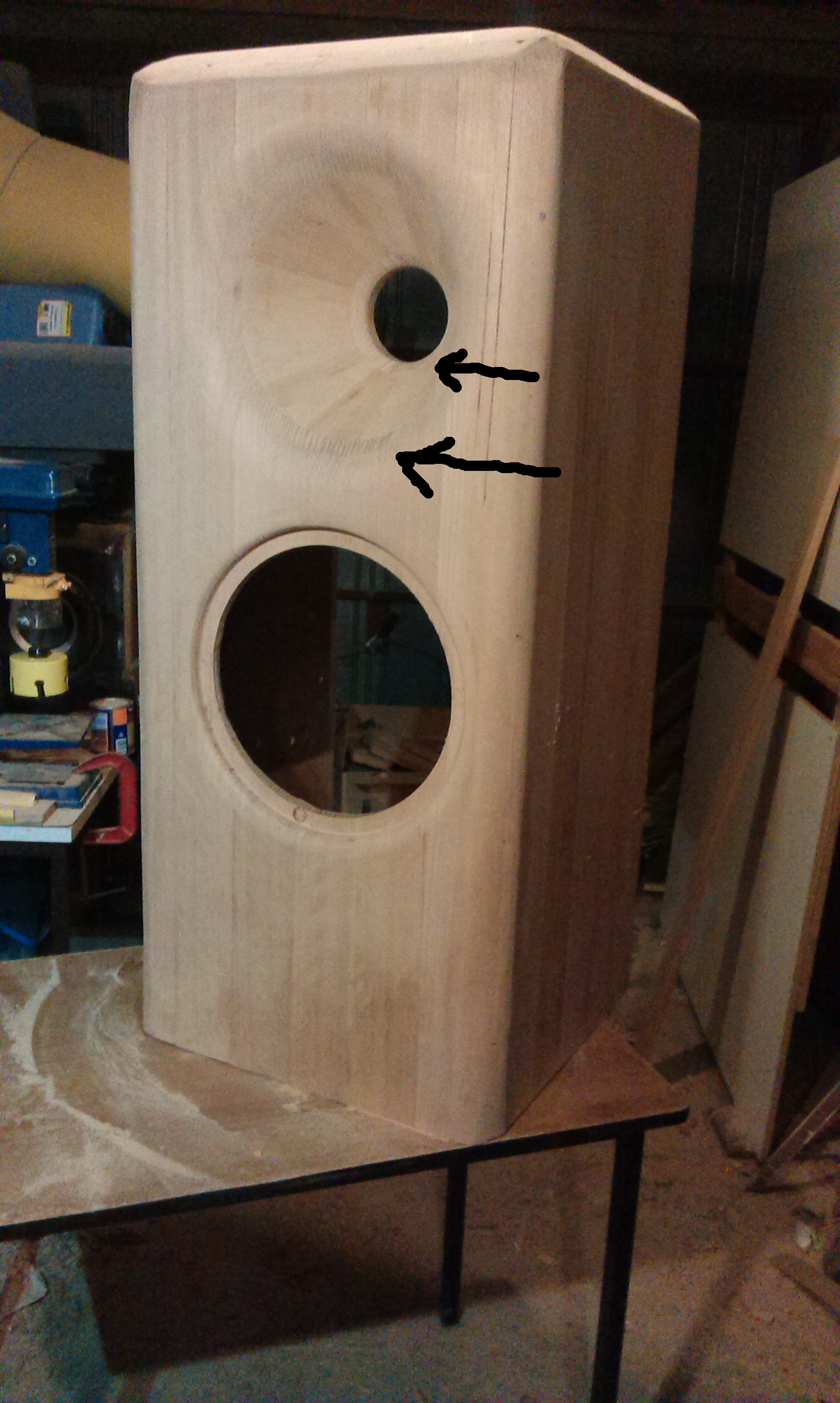

The take-home lesson of the last 15 (ish) posts is that a conical horn will sound a bit better if you put a bit of a curve at throat and mouth, like in the picture. The larger and smoother you can make the mouth curve, the better it will be... but too big gets awkward, obviously.
The DIY project I linked in post 9 is, IMO, a good example + fairly easy to replicate (or do a smaller copy).
I was trying to say don't copy that original link, at least try to understand it first.

First, I think that the definitions waveguides and horns is very blurred. Probably most would say that they are largely the same.
My cardboard 60 degree conical horns are intended to reduce dispersion (constrained directivity) to prevent early reflections, thus, they are waveguides. However, because they are conical, they avoid beaming (the pattern control of the highest frequencies is determined early on in the horn) that occurs with exponential horns, thus, with the help of phase plugs, the higher frequencies have a wider dispersion.
But, even with conical horns, the pattern control and the loading of the driver increases the output (the efficiency) at the listening position, thus, they are also a horn.
I could call them either a horn or a waveguide, or use either term, for that matter as both apply.
Second, I don't think that you need any kind of rounding at the throat of the conical horn if you are using a cone speaker. When Geddes was really touting the benefits of OS waveguides, it was really in the context of compression drivers, which come with an exit angle already baked in. Thus, you need to match the starting angle of the waveguide with the exit angle of the compression driver to avoid a sudden discontinuity that would contribute to HOMs. Cone drivers don't have any exit angle. I could see designing the mating of waveguide to the cone driver to avoid discontinuity (for example, in my case, the frame of the driver is exposed at the horn throat - I intend to avoid this when I make a permanent horn). However, a rounding of the horn throat provides such a discontinuity (although it is not too bad because it is rounded). I would think that a constant angle right from the termination at the driver at the horn throat would be the best approach.
Do I have any hard evidence to support my theory about this (and it is only a theory)? No. I do recall that a guy named JohninCR made some waveguides/horns for some cone drivers and tried both a straight angle and an OS waveguide style roundover at the throat. He thought that the straight conical without a throat roundover sounded better.
The data is clear, though, that a roundover at the horn mouth reduces HOMs. I think that a compelling example of that is the guy who spoke through a magazine rolled up as a megaphone, with and without a towel wrapped around the megaphone mouth provided the most compelling evidence of that. Clearly, the megaphone with the towel at the horn mouth sounded clearer.

Ideally, both driver and horn are considered as one coupling system, from the diaphragm to the horn mouth. This implies a smooth transition along the various components inside the system without major disturbances in the pathway of the wavefront.
The purpose of a roundover, mouth extension or "end- correction" is a smoother transistion from pressurized wavefront inside a horn to the surrounding air in order to minimize interferences.
