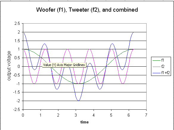

Say if I have 2 speakers, one is active, and one is passive. Let's pretend this is a 2 way speaker and the tweeter and woofer have the exact same sensitivity of 90dB.
On passive, this speaker would be 90dB sensitive. So one watt will produce 90dB of sound over the entire bandwidth of the speaker.
Now, on active, the speaker needs two amps. Since the woofer is 90dB sensitive, it needs 1 watt to produce 90dB for its bandwidth up to the crossover point, say 50-2000Hz. Now the tweeter will need 1 watt to produce 90dB for its bandwidth from 2000-20000Hz. So the active speakers needs 2 watts to make 90dB of sound? Where is my error?

1W of 50-20kHz does not equal 1W of 50-2kHz + 1W of 2k-20kHz.
The active speaker will be louder than 90dB.
If you had one watt going to your woofer and one watt going to your tweeter you'd get an SPL of 93dB, not 90. But when dealing with complex audio signals, one watt plus one watt does not add up to two watts. If both were reproduced by the same amplifier (and split later in a passive crossover), it requires FOUR watts, not just two. Remember, power is proportional to voltage sqaured, so the combined signal requires four times as much power as each one individually to reproduce without clipping. A bi-amped system with the same total power will always sound louder and cleaner.

For the same undistorted volume yes. The average power requirement is 2X, but the peak id 4X. Since amplifiers are voltage devices, you're stuck needing 4x. Each amp feeding the pink and green waveforms may be 1X watts. An amp at 2X the power would put out 1.41 (normalized) volts. Clearly, the blue waveform will clip. Real audio signals are more complex than this, so the situation is worse. And before you go off thinking that the tweeter power is lower (sensitivities being equal), it is only so on average. The peak voltages required are actually pretty close (there is a thread in the solid state section on this). A higher sensitivity tweeter that you can drive directly without padding if using an active crossover makes the active one even more favorable. If the tweeter is 6dB more sensitive, you can use 6dB less power in the tweeter amp. 106dB/W compression drivers have a real advantage over 96dB/W woofers this way, and is the only reason you can get away with a 100W tweeter amp while using a kW on the woofer. The same system passively crossed (with the CD padded) would need 4kW to play as loud without clipping.
