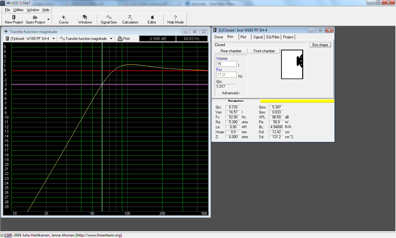

I used Win ISD to simulate a enclosure. It gives me a certain results.

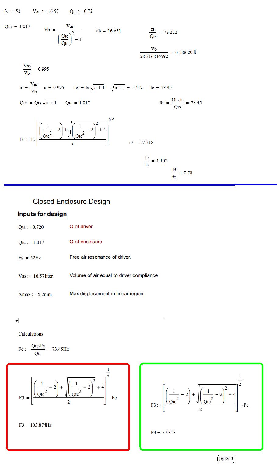

Then I calculated as per given vance Dickason.
I get a big difference. I am not able to understand what is correct. please guide.
Attaching Worksheet as per Mr. Dickason & the WINISD snapshot.
