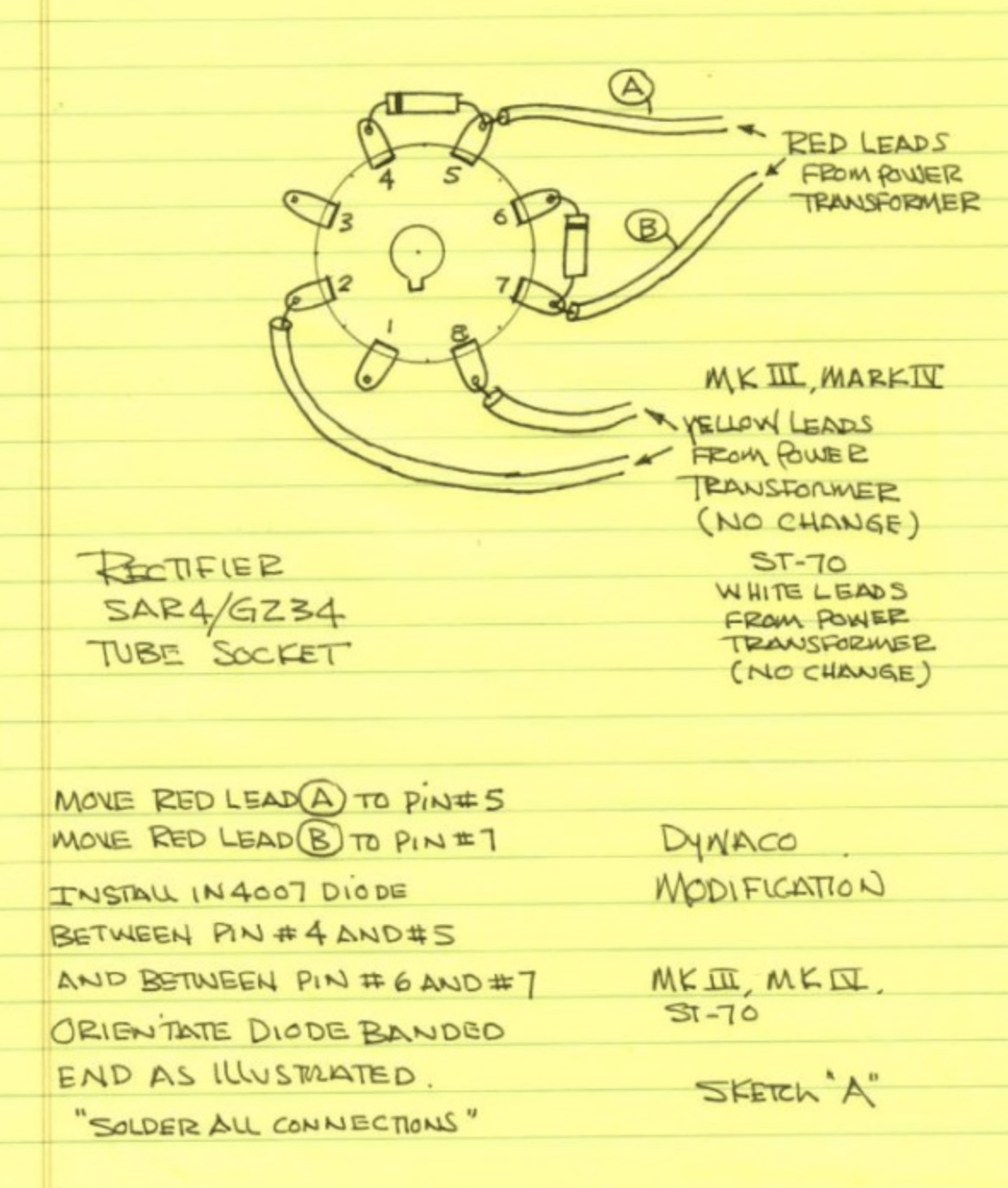

Great! And in the case of a choke input, directly to the choke?Except the wire from the socket pin 8 to the input capacitor is not shown.
Wish it were mine! Found it online a while back.Nice drawing
Yes, either the capacitor or the choke.
Point is, the only changes are adding a diode in series with each HV secondary transformer lead.
Unused rectifier socket lugs are tie points. Cathodes of the diodes go toward the capacitor or inductor.
The "yellow sheet" mod. Too bad someone didn't copyright it, they'd have some extra money. ;-)

And just to be clear... the function of the series diode approach as described above is to avoid a host of upstream and downstream problems if the rectifier fails, correct?Point is, the only changes are adding a diode in series with each HV secondary transformer lead.
I feel that this approach plus a thermistor to limit inrush current and two fuses - fast and slow blow - on the mains should provide a good degree of protection for the power supply. Can you see any downside - besides additional complexity - to this belt and suspenders approach?
1N4007 diodes have peak inverse voltage rating of 1000V, Right?
PIV
If you have a 400-0-400VAC rated secondary (when loaded), then the loaded voltage to the rectifier is 400 x 1.414 = 565V
When the secondary is unloaded, and the tube rectifier is unloaded (low voltage drop), there will be at least 565V B+ at the first cap.
(Before the output tubes warm up, the first B+ capacitor will have about 565V).
The peak inverse voltage will be 565V x 2 = 1130V.
If the tube rectifier fails, the 1N4007 diodes will also fail.
Use 1500V Peak Inverse voltage rated diodes, not 1000V rated diodes
