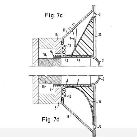

Is there a generalised 'effect' on breakup characteristics of a driver, depending upon its cone profile?
Visaton was in the eighties proud on it curved cone profile that shout help to prevent a wave to roll from center to the edge of the cone. The NAWI cone.
Nicht abwikkelbar.
This shout reduce effects where the cone is not stiff enough. Because it shout act like a piston. A piston of the size Sd with a extrusion and frequency gives a sound pressure. The piston shout be stiff to move always de same surface.
Nawi:Also discussed here.
http://www.diyaudio.com/forums/multi-way/210355-visaton-wsp-26-s-2.html
When you see a cone as a piston it is logical to make it flat so all acoustic centers are in the same axes.
Like this vintage active flatcone 3way loudspeaker of Philips(mfb), with a feedback circuit to the amplifier in the woofer. It is hard to make a flat light stiff flat cone.
