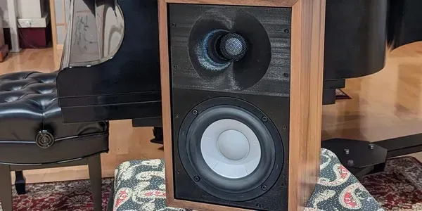

I've had good experiences with the ceramic coated aluminum drivers. Last week my two way speaker using the white cone SB 5" and white dome Visaton 1" dome, both ceramic coated aluminum, took first place in the two way category at the Pacific NW Audio Society Speaker contest. It's blind listening, not a beauty contest as all the others I'm aware of. The crossover is LR 4th order with notch at the high frequency breakup frequencies and baffle step correction. So these drivers will make the 1st order crossover gurus very disappointed. I think they are operating as a piston in this design with some dispersion control using a waveguide. In a multiway design it's not difficult to set the crossover frequency below the frequency where a driver starts to beam. It seems to me that the voice coil inductance value of many drivers is specifically set to counter the rise in response due to the narrowing directivity when driven by a low output impedance amplifier.
I think there can be some sounds associated with the cone material. Rub your finger across the cone and it will make a sound that is dependent on the material. That sound will be at a relatively high frequency for the stiff light weight carbon fiber, metal or ceramic cones. To excite that mode requires some energy getting delivered to the cone at that frequency. If the crossover steep and lower frequency there will be very little energy send to the motor at that frequency. However it would seem that non-linearity and asymmetry in the motor, suspension or surround can create harmonics of the drive signal that will excite that mode even when it's attenuated by the crossover. There is a lot of talk of rocking modes in low cost dome midranges causing problems for instance.
