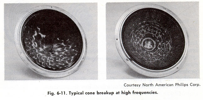

IMO, most of the time, cone breakup starts at a much higher frequency. Starting from a certain frequency, you will see valleys and hills. Valleys are at the frequencies where the cone breaks up in such a way that half the cone surface is moving "in phase" and half of the cone surface is moving "anti-phase". Hills are at the frequencies where no anti-phase islands do show.
Hills don't exceed the nominal level (no gain), unless the loudspeaker is equipped with a cone that's breaking-up at a frequency that's lower than the natural extinction frequency. You may consider this a terribly poor loudspeaker, but unfortunately, that's what you will get each time you need an inexpensive subwoofer. Not a big issue as anyway, you will lowpass filter it at 120 Hz or so.

Here's an interesting picture of cone breakup.

The frequency response of a loudspeaker cone is affected by three main factors:
Material Characteristics,
Diaphragm Geometry and
Radiator Size.
In this setting two sound velocities are responsible for determining radiation characteristics of a driver: One reflects the speed of sound traveling in the diaphragm material, and the other reflects the speed of sound traveling in the surrounding air.
They jointly determine the frequencies at which wavelengths become comparable to radiator dimensions. The resonances that arise in these domains combine to either reinforce or cancel driver response at these frequencies.
The severity of these anomalies is determined by the mechanical properties of the diaphragm materials and geometry used.
