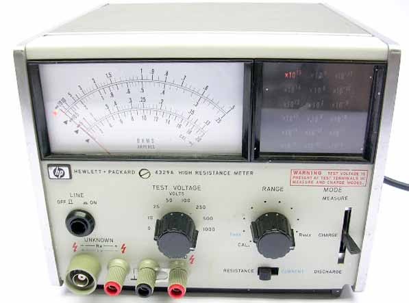

I lucked into an HP 4329A at a surplus sale. These are high resistance ohm meters that read from 500K ohm to 2x10^16 ohms! They are ideal for the measurements needed for ESL development and repair. Keep an eye out on eBay or elsewhere. They don't show up often, but they shouldn't be too pricey when they do. (At the same sale, I also bought a sister product, the 4328A, which is just the opposite kind of meter; it measures milliohms, but also useful for audio.)
