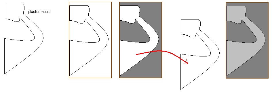

Would it be any good to make a speaker out of concrete? Since it can be poured into a moulding, you could make complicated horn designs more easily. Its certainly very dense which is a good property I believe? Of course problems would occure trying to make anything other than small bookshelf type speakers due to weight, but for those smaller speakers it might be worth a try.
My idea for moulding one isn't fully formed, but could go a little like this. Mould the open horn space out of plaster of paris (sp?) using hands and hand tools (probably a better way). Once set, fix to a wooden framework. Pour in concrete around it. Hopefully the plaster comes away from the set concrete easily (vaseline the plaster?), leaving the horn passage/mouth etc. Turn over to pour the other side panel. The front and back would just be wood, fixed with wall plugs and screws.
I see potential difficulty in removing the plaster mould since if it isn't symmetrical it will become wedged. It is possible to do 3D type moulds I would think by casting half at a time. Any thoughts?

One trick that I've had good luck with (using jewler's investment, which is essentially super-quick-setting brittle, crumbly concrete) is putting the mould in a vaccum chamber. The action of the pump both vibrates it (it was on the same table) and pulls out the air bubbles.
