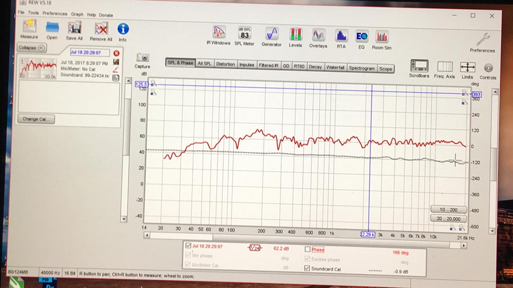

but this is the bookshelf+subwoofer, before any eq just a 12db/oct cut at 250hz and same filter hi pass for bookshelf, almost flat across the board :

Build looks good. I'd recommend dropping the crossover down to <120Hz, though - it'll help the sub disappear better - having it running up to 250Hz would make it very easy to locate, and will pull the stereo image to one side.
Next up, fix the treble rise on those speakers - that's a 30dB bump over the lower midrange level!

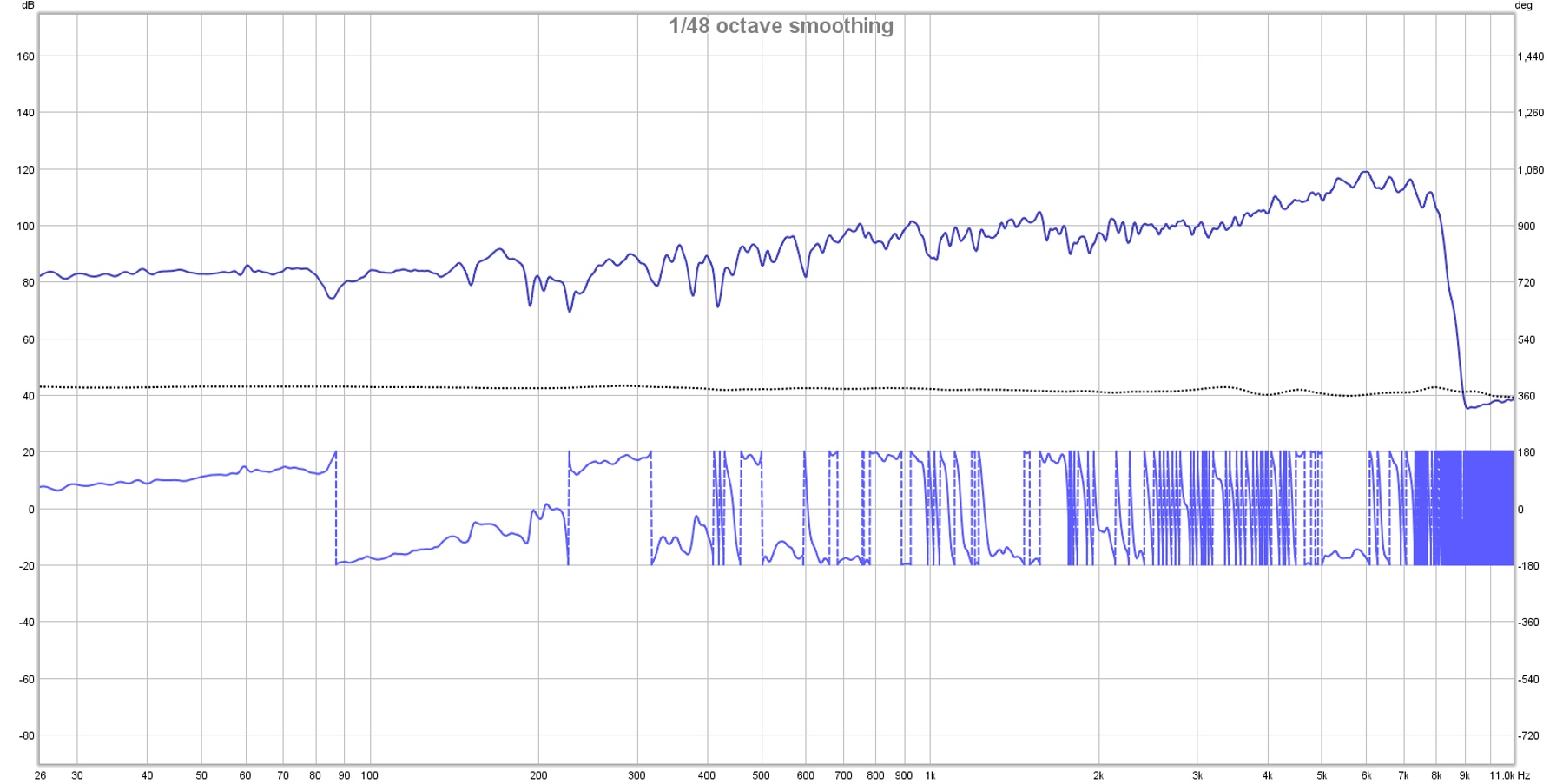

I was already tweaking around in minidsp as i was reading your reply, i did brought it down to 120 and man what a difference it made, thanks for the tip :)
as for the treble rise i m not sure what is happening the last time i measured the speakers it was flat across the band :
attachment.php
nothing changed since, same setup, amps, mic and everything, i m probably doing something wrong here.
need to do some new measurement.

Nice FR :) What level did you test at ? It seems very ineffecient though ! Not criticising, Only noticing ;)
Thanks :) the measurement in post #11 is the bookshelf alone, without the dsp or anything, it is an old school american JBL monitor, i did not calibrate the SPL at all, as soon as the mic gave me a reading i was happy :)) ( also didn't want to scare away the neighbors ) i was not patient enough to do a precise measurement and i just start doing this as a hobby, not enough tools and equipment at the moment.
