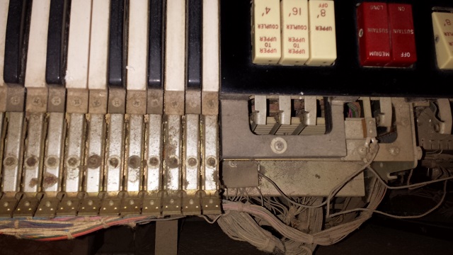

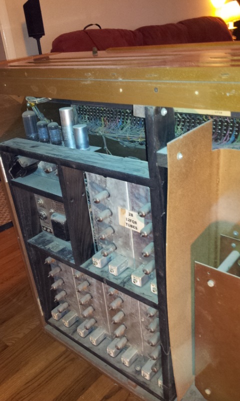

Concerns about a 54 yr old Wurlitzer vacuum tube organ & safety of old electronics

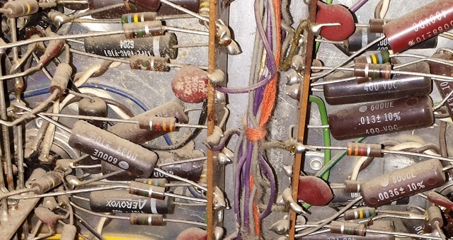

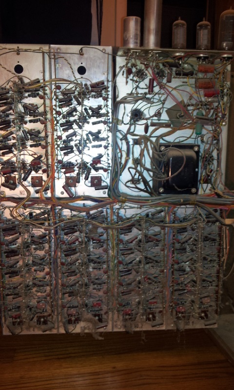

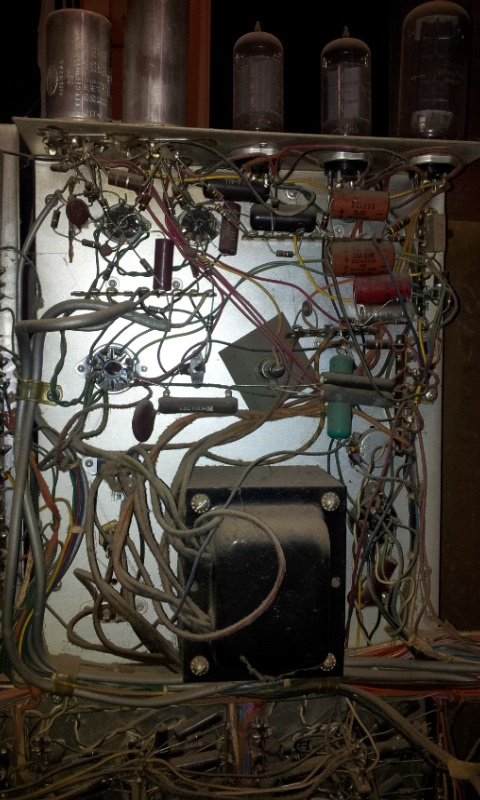

My musician son recently acquired a Wuriltzer 4100BW organ (1959-1963) in very good working condition. He's plugged it in and says all keys, buttons, pedals, switches etc work and it sounds great. We took the back off and it's dusty/linty inside and I don't think it's been maintained in years...dozens of tubes. It's staying off power until we can decide how safe it is and what's involved with getting it safe, happy and healthy.
I'm electronics hobbiest with an equipped bench but I know nothing about vacuum tubes and never work with mains power other than the occasional power supply projects.
I think it would be a fun project to put the organ in order and I'm looking forward to doing the research and the work.
But I have not ruled out turning it over to an experience repair shop, either.
I'm embarking on a search and research mission and I'm starting at diyaudio instruments forum for sound advice. Except... I've located Morelock's in Mississippi who have the service manual and all parts...so far the only advice they gave me is ...if it isn't broken, don't fix it. I will order the service manual.
Here's my concerns -
Is this thing safe to use as-is?
Is dismantling it...following service manual instructions...and cleaning off the lint, contacts etc, sufficient for safe operation of electronics this age?
Or is that in the realm of .... if it isn't broken....?
Can an aged, failing component take out the entire system? Or will the fuses handle any failure?
I have looked over this sobering thread -
But I don't want to throw in the towel yet. Nor burn down the house or worse....
Any other advice, suggestions, names, links etc? ...and I'll continue searching....

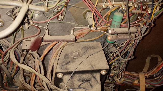

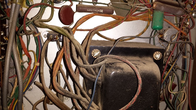

The one thing for sure is to provide a three wire power plug with the green ground wire secured firmly to the chassis usually by installing a crimp-on ring connector and securing it under a nut that holds the power transformer or something else close to where the power cord comes in. Scrape away any crud by the nut first to get a good connection.
Get rid of as much dust as you can as this will allow the tubes to cool better. If there are vent holes that are plugged up, clean them out for better air flow.
Check the fuse to see if it is the proper size and type. You might want to replace it as it could blow more easily from being old. It's cheap protection.
It depends how much you want to dig into the amp chassis and how much you know but you could check for proper voltages for the B+ supply and other key voltages. There is a pretty good chance the filter caps will be needing to be replaced, although I have restored four Hammond amps, two Bogens and a few other PA amps all made in the late '50s and early '60s and turned them into guitar amps and have not needed to replace any filter cap. As long as it is working OK, why not just see what happens? You can always replace them later.

To answer your question about one component taking out everything, the biggest risk would be the power tubes shorting out. It could then take out your output transformer. If you can't test them, I would be tempted to replace them. Are your main filter caps the multi-value can type mounted on top of the chassis? When regular style electrolytics go, they could splatter their guts all over, but not always. Usually they develop a bulge or leak on the ends. Not so much on those can type caps. And they aren't mounted inside where the other components are.

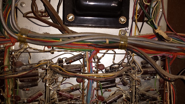

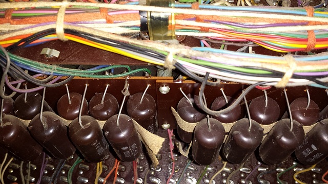

The electrolytic caps the second most likely component IMHO to fail. If you don't want to deal with it, Morelock's is famous for doing amp rebuilds for people. The good news about the 4100, there is not much but the amp to have e-caps in it. The rest of the organ is metal reeds and an air blower.
The third wire idea is fine only if the organ hasn't been rained on, so the cotton insulation in the power transformer is rotted. If it is rotted, putting a third wire on the chassis may set the transformer on fire. Many failing churches had roof problems, and this got to be such a problem in old Hammond organs they have a test for it on page 2 of the service manual for Hammond model A, A100, B, BC, BV, B2 blah blah on archive.org. You could have morelock's do this test when they re-e-cap the amp.
If you want to replace the 2 or 3 e-caps in the organ yourself, see this thread about replacing $40 tall cans with two to four radial lead capacitors rated 3000 to 10000 hours service life: http://www.diyaudio.com/forums/tubes-valves/201265-vintage-magnavox-tube-amp-3.html
Be sure to read the safety sticky thread at the head of all sub forums of organforum.com before you attempt to do any work with the back off. It is much more concise than the diyaudio one which wanders off into microwave oven safety about post 2. There are posts about your organ there, mostly under home organ sub forum, but also under the organ repair subforum.
A third component likely to cause trouble in 1959 was the carbon comp resistor, that could change value due to moisture. This is most likely in higher value resistors, 100 kohm and over. These should be checked with an ohmmeter after the power is off and the B+ discharged (see the safety sticky thread). Any with burned paint should be replaced anyway, the paint is what keeps the moisture out.
Also in 1959, paper capacitors not sealed with wax could wander off value due to oxidation from the air. Wurli 4100s are not famous for this, but if you own a capacitor checker you could check the value on the tubular caps. Guitar people always change the paper caps with high voltage on them to the plate or HV grid, but Wurlitzer used a better grade of cap IMHO than guitar amps and I haven't heard of a lot of these shorting out.

These tube-generator organs always have a LOT of tubes in the tone generator, and that takes up MOST of the electrical power and generates MOST of the heat.
I (mostly) agree with what's already been said: Since it's operational, just clean out the dust and replace the power supply's electrolytic capacitors, and it should be good to go until something breaks.

The death cap of course needs to be removed, but the fact that there was AC on the chassis means that it was not effectively grounded whether by a grounding failure somewhere else or by an actual wiring mistake when the 3 wire cord was installed. The grounding conductor is sized (same conductor gauge as the current carrying conductors) such that the full fault current should not result in a hazardous potential on the chassis if everything works as intended.
he did install the new line cord incorrectly as i mentioned.and as i was not present at the show where he burnt his lip i can't say for certain that the receptacle he used was grounded but the mic sure was!
With the amp of a Wurlitzer sitting inside 50 lb of hardwood, setting fire to the amp transformer by installing a third ground wire on an amp with a leaky transformer without checking, is way more of a fire hazard to the house than a hifi amp sitting out on a glass shelf somewhere where someone could touch it.
Do the leakage test before installing the ground wire. I did on my H100. The hammond leakage spec in the document quoted (service manual on archive.org) is about 1/4 the current of the trip point of a ground fault interrupter socket.
Furthermore, rather than grounding the chassis buried down in the bottom of the walnut case with a wood cover on the back, I third wire grounded the metal keyboard chassis I actually touch: Using no connectors but crimped 20 amp rated ring terminals to 16 ga wire, machine screws and nuts, and stainless star washers to the sheet metal per the safety boards spec of more than one contact point to every surface accesible to the consumer. My H100 power chassis where the power cord comes in is connected to the metal keyboard on the ground by 6 amp rated AMP Mate-n-lock 2 connectors, that could easily melt away under a 20 amp dead short.

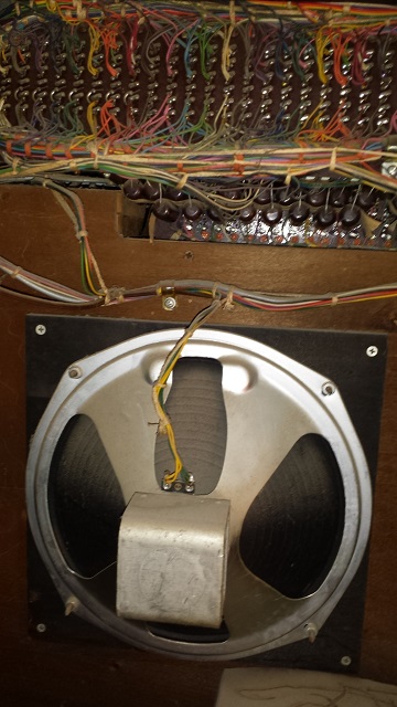

Finally found time to plunge into the organ. It was a massive eye opener. I thought I could pull the PS & Amp and bring it back to my house for cleaning and testing. Ha! Massive busy cable harnesses, all soldered down. It was a very gratifying vacuuming experience but I need a strategy for cleaning this and doing the testing in place. I didn't see any obvious exploded or burned items. Cloth wires at the transformer. Those who send the amp to Morelocks for a refurb...this is a "project"...right? I'm going to figure out how to do the transformer leakage test first, without dissassembling anything. Tips and tricks appreciated. And I'll keep studying. Thanks so much for the help so far. Here's some pix:
from the pic's it's cleaner then some i've seen and worked on!
small used tooth brushes and Q-tips make cleaning in tight spaces easier.(be careful during the cleaning process not to move too many components back and forth in an effort to get behind them to clean;flexing the component leads can break them away) keep the vacuum close at hand. try to avoid using high pressure air to blow it out and steer clear of the temptation of "dousing it with contact cleaner"
don't neglect removing the drivers to clean the front side of the cone you'd be surprised as to how much small particles of schmutz can make it through the grill cloth with the typical build up at the bottom that can make some drivers sound frappy or cracked.(good time to check them for damage)
don't use glass cleaner with ammonia on tubes it tends to remove the numbers!(mild dish soap and warm water don't immerse them for the sake of the pins developing corrosion)
other than that patience and a methodical approach and always make notes!
