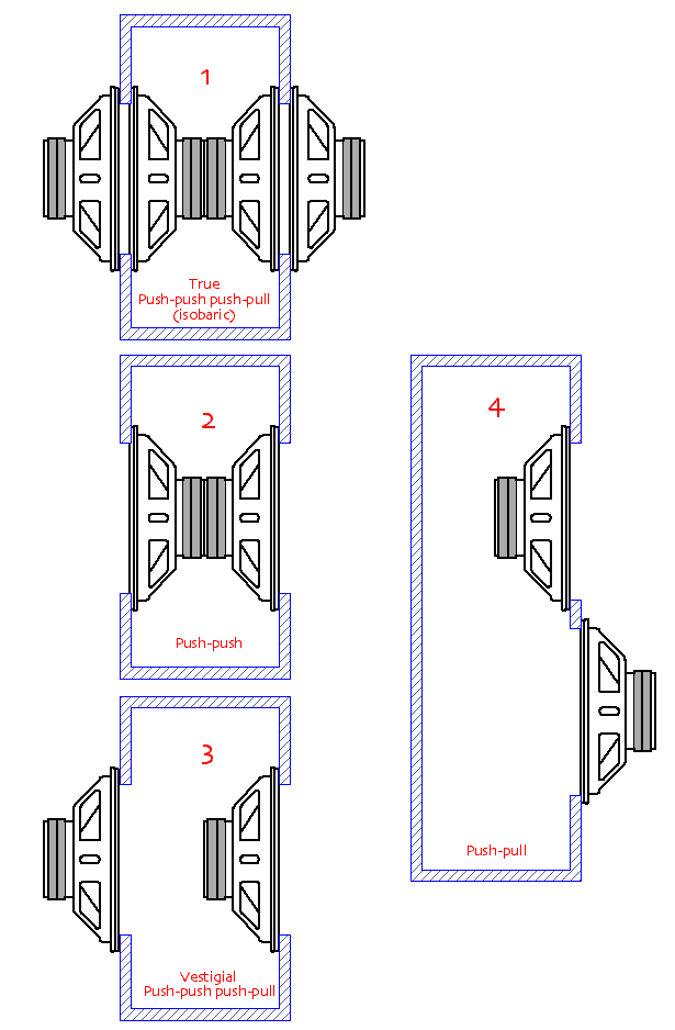

4x5" drivers give the same area of a 10" driver.

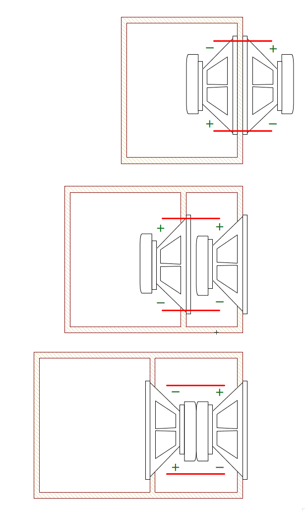

The 12 inch Peerless works great in a 60L sealed.
Is the depth of the bowl sufficient to fit an 8" driver? I know that it will be worse for the volume, but that I will figure out later.
@Jakubg, yes you could fit this over most 8" drivers. I remember putting over some old Celestion 12" drivers, just.
First thing that comes to mind, speaker theory aside... mounting and keeping it rigid will be a hassle in itself!
- Subwoofers
- Concept, Beolab 11 style isobaric sub using Ikea Blanda metal bowls.
