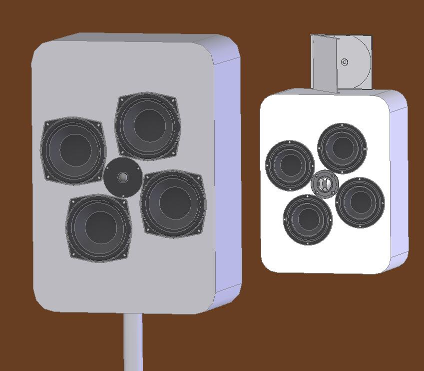

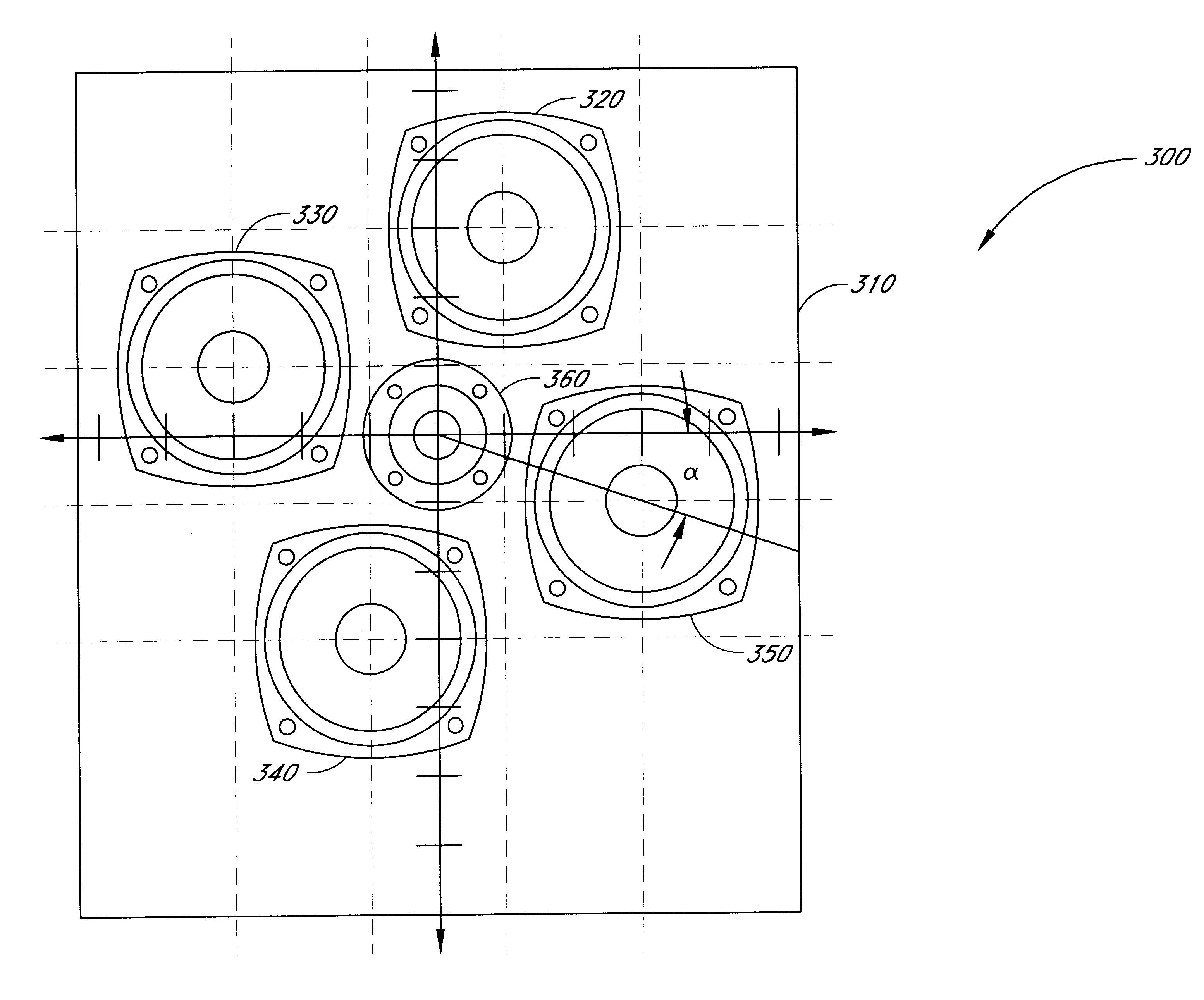

Concentrically-arranged mids around a tweeter
To add to Charlie's points, It's not a lobe that is created by non-coincident drivers, but two "holes" in the response (one up and one down in the plane of the two drivers) - Holes and lobes are quite different things. These holes have little effect on the power response since they are so small. They will move in and out in opposition with the driver spacing and they will move up and down in synch with the inter driver phasing at the crossover point. The MTM situation will create vertical lobes from the two M drivers, but no "holes".
Let me give you a concrete example of what I am talking about when I say there will be response problems in the vertical direction for an MTM caused by interference between the M drivers. As Earl pointed out, these cause nulls or "holes" in the response. The attached plot is the vertical response -30deg to +30deg (see legend) of an MTM system I built comprised of two 7" woofers (Exodus Anarchy) and a very small compression driver+horn tweeter (from DIYsoundgroup, NLA) sandwiched in between them as tightly as possible. The system was crossed over around 2k-2.5kHz IIRC. You can see the hole (looks like 2 dips really) from about 800Hz to about 2.5kHz reaching over 12dB deep at 30 degrees off axis.
If the rest of the system's frequency response was down 12dB at 30 degrees off axis that would be fine. It's when only a band that wide (about 1.5 octaves) is up or down by 12dB and the rest of the system is flat, it's less than ideal. If I could have crossed over the M's to the T at 800Hz, there would be no dip. That's what I did in another similar system in which I used a small full range driver as the tweeter and I thought it sounded very nice. I took apart the system used to make the attached plot soon after making these measurements on it. There was no way to "fix" the response problems with the set of drivers I was using (it also had some response problems in the horizontal plane) and it did not sound good to my ears.
The large majority of MTM system I have seen use a crossover point (2kHz or even higher) and/or the midwoofers are too widely spaced apart. Adding yet another pair of M drivers (like the DNA Sequence does, with one on each side of the tweeter in addition to the one above and below it) will only make holes appear in the horizontal responses as well. This results in a very narrow spot in space that has flat response, directly on axis with the tweeter. Moving off axis in any direction will put you into the "hole". This is exactly what happens with large planar/panel systems like the Quads and that was why it was very telling that was shown as a listener comment.

Judging by the horizontal and vertical response plots, it looks to me like the crossover point is below 1kHz, maybe around 700 Hz. I don't have an AES subscription so I can't read the full paper. Keep in mind I didn't say the MTM concept (or even multiple drivers around a central one) could never work, only that you need to cross over very low in order for it to do so. This is usually about one octave lower than you can go with your usual 1" dome tweeter, that is to say you need to cross over around 750Hz (a bit lower is even better). At this wavelength the M-M driver spacing can be made about 1/2 wavelength or less, and the off axis holes are minimized.

I also would like to point out that I am confident that the techniques shown here could be made to work reasonably well. I have no confidence that they would be an improvement on the classical approaches in term of directivity control, power handling or cost. I think that best case they might approach a well engineered two way waveguide woofer system in all of those areas, but I see no reason to believe that they would best the older designs in any of them.
