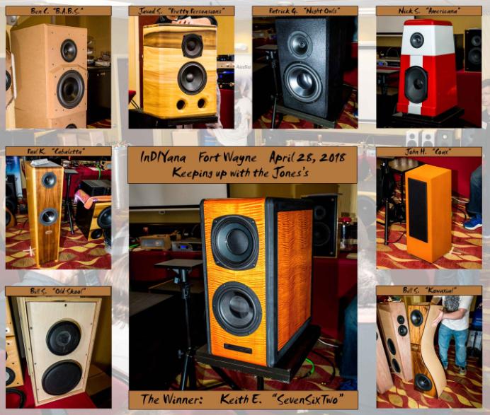

There were several coax and woofer 3-ways from a few years ago at InDIYana 2018. Look up 'Keeping up with the Jones', and see what pops up.
Bill's 'Kowaxial'
Ben Cooper's 'BABS'
Keith's 'SevenSixTwo'
Etc...
