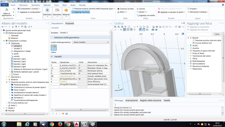

good afternoon to all, i'm a DIYer and I would like to try something different..
and that's why I turned to you, and so I hope I can fix it and share the result with you..
I have spent the past few years using akabak and hornresp, enough for me, but now, I would like to build a 6.5 "midbass, complete with phase plug, but I would like to analyze the behavior of the wave through the phase plug.. and at the same time analyze the directivity and response of pase and frequency of a determined woofer (represented by t/s parameters)
i've tryed abec3 but it doesnt look exactly user friendly😕
I started from this project:
https://www.comsol.it/model/lumped-loudspeaker-driver-12295
i tryed to turn the model to 2D in 3D, but now I have some difficulty in defining the radiation of the acustics in the domains to determinate the vector for the acceleration of the woofer...
i'm not a engineer or student, but I would like to expand the possibilities of self-builders, to be able to simulate 360 ° a specific item.
For this I would like to provide to all a template or project,in which the input we have:
Driver t / s parameters
variable driver (my problem)
3d model enclosure whit sketch woofer, air domains and PLM
The COMSOL model file should be able to give away the results of sensitivity and Phase..after thath everyone adds what he wants,
But before it can go ahead I would need a little help me regarding the transformation of the t / s parameters in woofer acceleration function🙁🙁
in attached the simple 3d version of the comsol 2d Lumped Driver

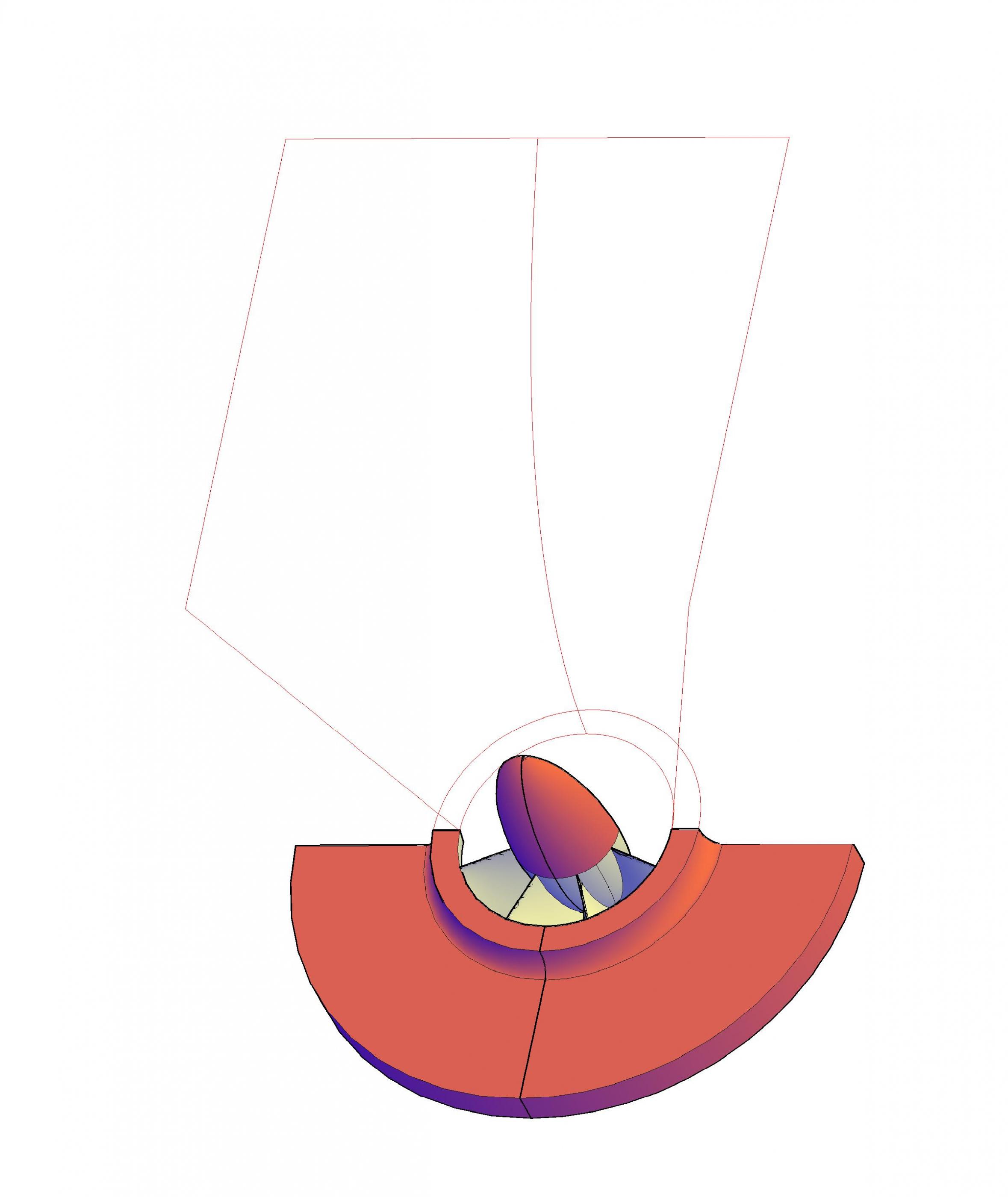

good morning, thanks to the answer, to tell the truth I should design the trumpet for a medium horn powered by a b&c 6MBX44...to increase the response frequency of up to 3000Hz ... is essential a phase plug to decrease the volume of the compression chamber (and prevent various propagation delays) ... now you can imagine that no 2d program you can not simulate everything.. (unless it is not symmetrical along an axis, but a trumpet unless it conical it is not)..
in any case I wanted to create a template that you can use with any 3D model ...

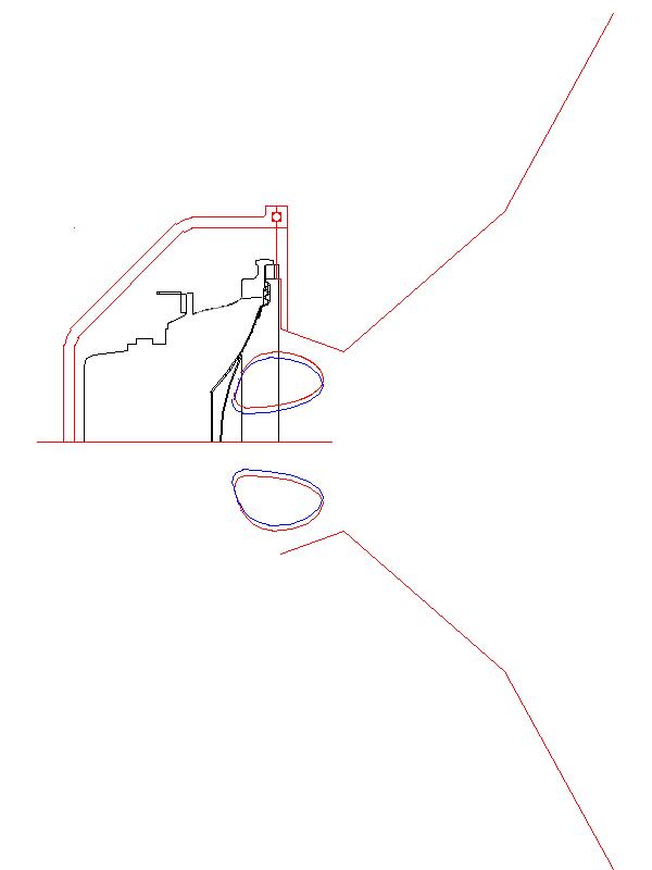

Recommend ...
... you use Phase Plug geometry of the CMCD-61 [1] as a starting point.
PG Mission:
1) Reduce front cavity volume.
(you can tweak HF by setting resonance here but beware of clearance needed for [Xmax] when doing this)
2) Mitigate Cavity Standing Wave Modes
(three rings are sufficient to do this and the dust cap influences them as well)
3) Approximate a coherent wave front at plug exit.
(shoot for uniform volume velocity in the annuli as well)

anyway this the midhorn that i want to simulate first to build

Good morning everyone and thank you for valuable information
then I would distinguish between two elements
-to define the trumpet for the chosen woofer (300-3000hz range)
-simulate it in COMSOL
well i,ve one problem for point.

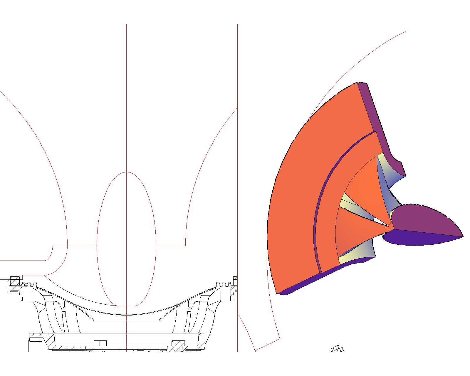

- how to definite a phase plug for the midbasses whit the concave dust cap, i suppose that the farest point of the dust cup (the center) the pressure generated there must be an advantage, so I dropped the idea of a like turbosound phase plug or this (http://www.centauriaudio.com.au/diy/plugs.html)...and I have chosen for simplicity to dimension a toroid ...but I do not know how to cover the cone without creating pressure problems ..

The presence of a concave dust cap simplifies phase plug design. Again it should follow the diaphragm profile.
Use a compression ratio of about [Sd]:[St] = 4:1 to avoid "pressure problems". WHG

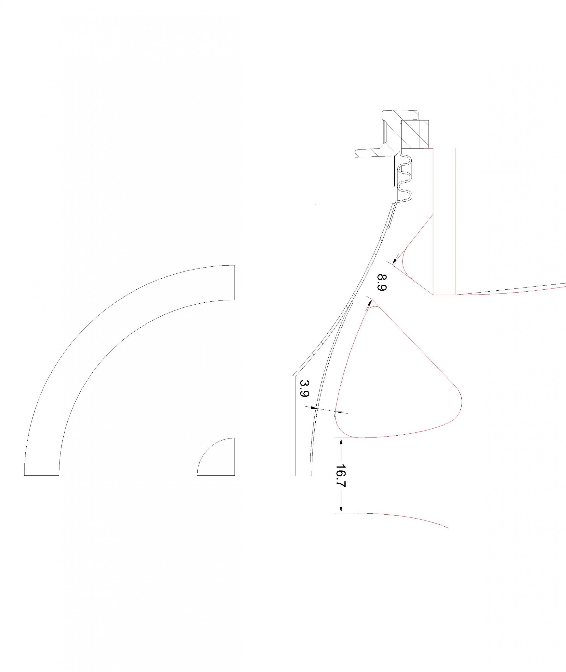

thanks a lot whgeiger....i've readed the jbl note, and here the compression ratio is indicated about 7/1..but they used a particular phase plug, anyway i've

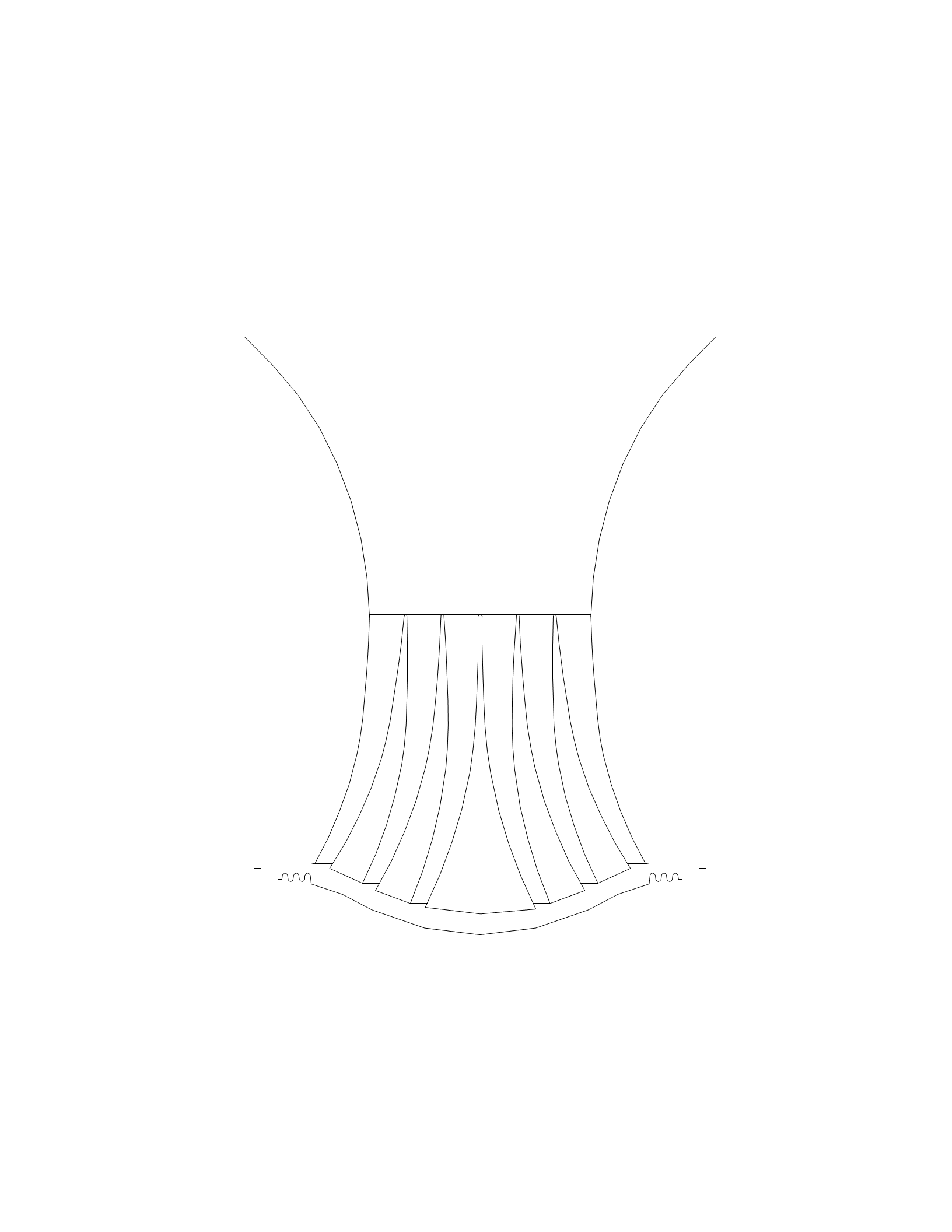

I redesigned the phase plug, and I focused on a more traditional horn throat ad i've a ca 25cm2 of circular area free..
The woofer has a 3.5mm xmax, I thought that the distance between the phase plug and the cone can be 4mm, although the filtered woofer doesent reaches this excursion

Notes
1) Plug/Diaphragm Clearance
You are not allowing for manufacturing tolerances and you are assuming that the driver will never be moderately overdriven beyond its [xmax]. Recommend 6mm min. clearance. Check driver [xmec] and use that as a guide.
[2] Phase Plug Geometry
Nix the center hole and use 2 or 3 annuli

Try This
Concept Drawing, dimensions only approximate, plug could be shorter as well. Horn section at mouth? Circular? Other?
WHG
one step at a time ..but I need a 3D printer
anyway, i've used a mix of all documents proposed..the next step is procjet the horn and simulat all...
WHG
- comsol 3d simulations
