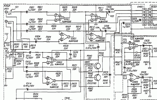

One possibility, it is your amp's input structure that allows ground loop. So it is that amp's input that needs modification. Here's an example of input structure that rejects ground loop, from patent #5440643. Look at Rch and Lch, it has 22k and 100ohm ground resistors before C601-602, and feeded to differential IC601. It passes signal and rejects grond loop.
Or, easier way, use 1:1 isolation transformer, like many suggested.

Lumanlauw has a good point, amps that don't isolate the
input and "dirty" grounds are more prone to ground loops.

my PC is not a dell, its one I built myself. The case it is built in is of server class so the case should be up to the task of grounding.
The amp is quite old (1987) and has a very simplistic design so I would not be suprised if it not double insulated or allows ground loop. My old amp (which I bought about 2 years ago) didnt have the problem.
I have ordered one of those 10 quid isolation transformers which will hopefully help.
I can post a partial schematic of the amp if it is of any help.
