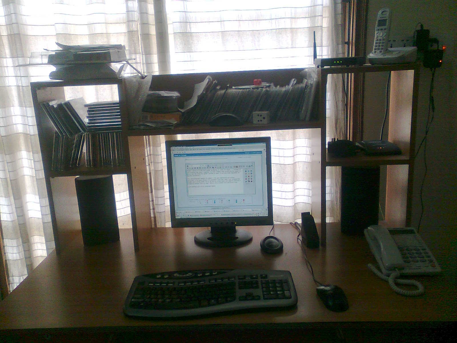

Any recommended designs for alpair 7. My size restrictions are wxhxd - 9x10.5x9". If no good designs are possible in this size, then I can increase the height, but I would prefer not to do that as in that case I will need to remove a couple of shelves from my desk. Bass is not a concern as I will have a sub.
I am posting a pic of my computer desk. sorry about the crappy quality mobile picture. The speakers will come where the current speakers are.

anything a little smaller than that? specially height.

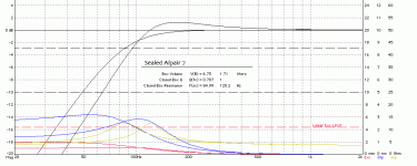

The boxes i presented are based on 9 litre internal volume and i feel the optimum for a vented enclosure. My feeling is that if you need less volume you go sealed. Sims attached.
You have 9.1 litres of gross volume (assumming 15mm box walls), and any volume for ports, back of driver, and braces has to come out of that volume.
Do the dimensions given allow for space between the box and the shelf unit?
For more extended bass in a smaller cabinet the CHR70.2 is better suited.

Sealed is ok with me. can i still cross the sub at 80hz? i can go higher too, say at 120. does localization become an issue at 120?
Yes, I have allowed for some space between the speakers and the shelf. the actual space available is h - 11.25" and w - 10.5. Back side is open, so depth is not an issue. I have left out more space in width in case i need to toe in the speakers. If in the final design, internal volume is the only criteria, then I would prefer to restrict the width to some 7-8" to leave more space for width. WAF in action here🙂

out of the two, I would prefer the 6.93 ltr of course, if I can fit it in the area.
If I use 15mm double baffle, how do I figure out the driver displacement? Does it make sense to go for a double baffle in such a small speaker? With single baffle I would probably have to surface mount the speaker.
when I try the simulation in winisd with sealed 6.73 litres, it exceeds the excursion limits with 20w at 90hz, 12w at 65hz. Am I doing something wrong here. Do I need to highpass the speakers. I will be using it with a sub with a crossover, but if I connect just the speakers and without the soundcard highpass, will it go bust.
