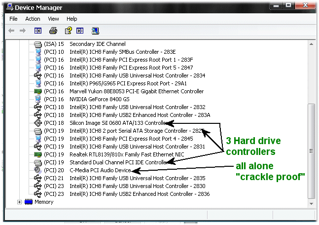

By KSTR - it's a general problem whenever massive HDD access occurs for whatever reason
Try changing PCI slots for your soundcard. Look in device manager and make sure SC has it's own IRQ. (see below)
I can get get any of my sound cards to crackle if they share with the IDE/SATA busses.
I say this with confidence as I have 2 NICS reading and writing to 6 hardrives 24/7 (torrents and kids on network) while using the server as a HTPC/main listening machine (16 avi's simultaniously ) .. never a crackle.
USB controllers can share with sound cards on most newer MB's because they make use of the faster bus.
A sound card/videocard share is deadly in windows (BSOD) , that is why PCI-E sound cards suck. http://www.newegg.com/Product/ProductList.aspx?Submit=ENE&N=2010290057%201102631935&name=PCI%20Express
If you read the "bad reviews" , it is all from gamers (3D graphics)
overloading the same bus that their fancy new sound card shares.
(crackle - pop)
OS
The IRQ thing is great advice. Make sure you are not sharing IRQs with another device - sometimes this might require you to disable a usb port in the Device Manager.
But also sometimes it can be hardware driver related - a Network Interface Card can commonly hog a computers resources and cause DPC Latency to spike upr making your computer lose sync with the card. This seems to be a lot more common on Vista than XP.
Thanks again, guys.
Soundcard has its own exclusive IRQ. The board is rather old, an ASUS P4G8X, known to have issues under high PCI bus traffic.
As I said, the problem is only with foobar+XP, also it does not depend on which driver type I select (MME/DS/ASIO). Anyways it is all interim, as a dedicated audio PC (bare-bone linux) is planned, for just the same things that Theo404 does (active XO etc). For the moment I can live perfectly with MediaPlayer Classic for the reasons mentioned that won't allow use of foobar.
- Klaus
- Klaus
