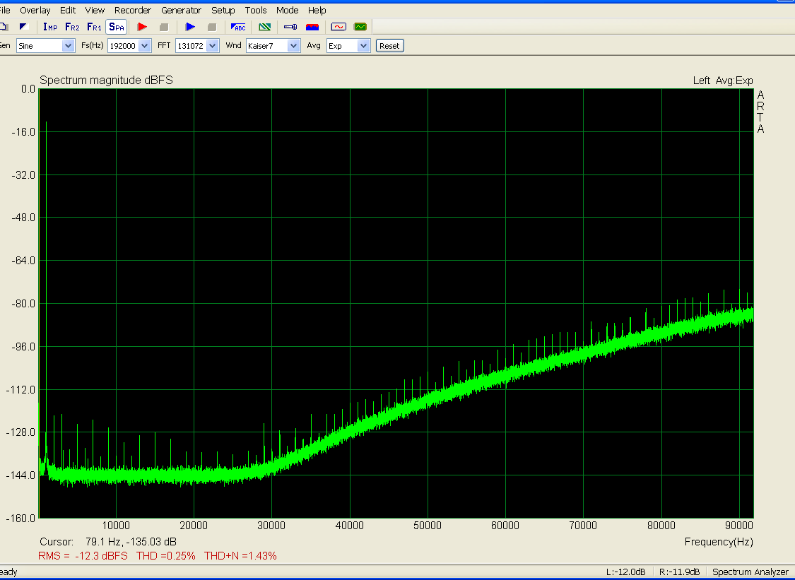

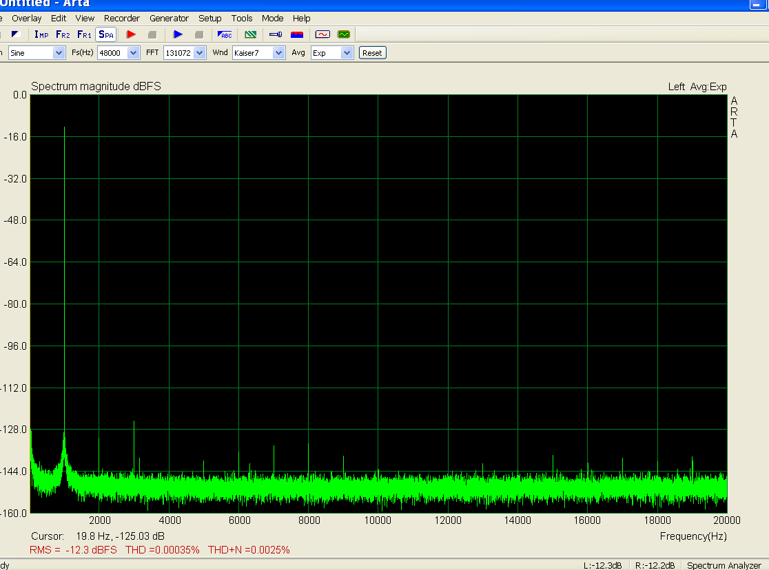

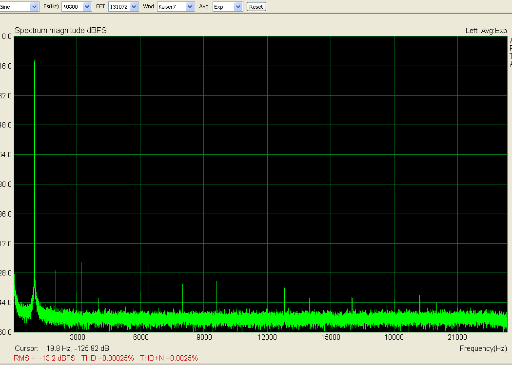

I now have my EMU tracker pre working pretty well. It works much better with ASIO and is not usable on WDM at 192. only certain ports on my computer work with it. Their driver does not like the USB3 ports.
Great performance at 48K.
At 192K even though the harmonics are the same ARTA adds in the HF stuff that starts at 20 KHz and takes .00035% and turns it into .25%.
Both the DAC and the ADC have the HF issue but the ADC is still quite good (image 3)
I need to find my EMU 0404. It should not have that HF issue.
