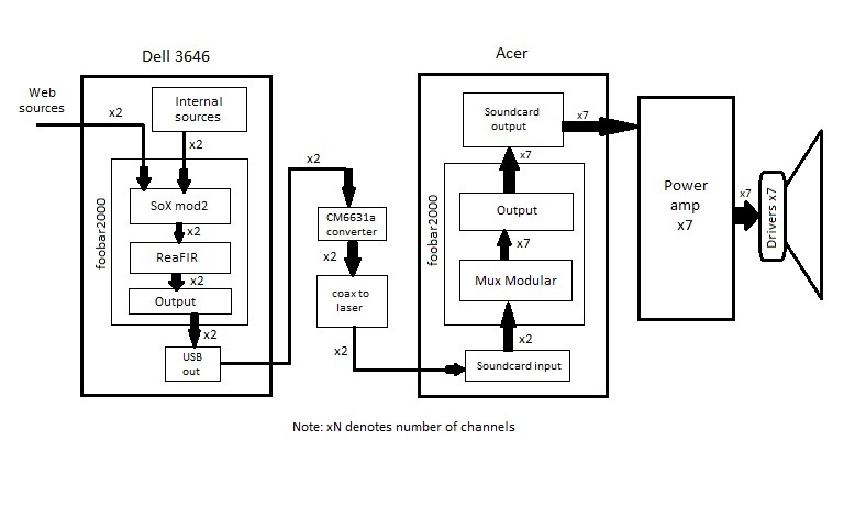

In summary, the system currently comprises:
1. Source/preamp stage: a Dell SFF desktop houses music sourcing and front-end DSPs.

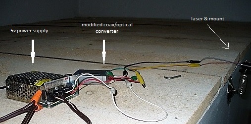

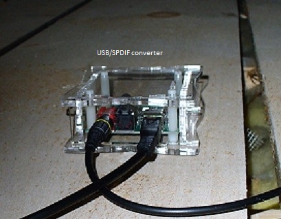

2. Link to crossover/poweramp stage: a CM6631a-based USB/spdif converter feeds a modified coax/toslink converter that powers and modulates a 5mw laser which illuminates one end of a fiber optic cable 40' away.
3. Crossover stage: another SFF desktop (Acer) armed with a CM8828-based 7.1 pcie sound card acts as a multi-driver stereo crossover/DAC. It accepts stereo spdif input from the laser and sends 7 channels of output to the power amps.
4. Power amp stage: several single-rackspace power amps, some using TDA7492 boards and some Sure AA-AB32971 boards, accept soundcard output.

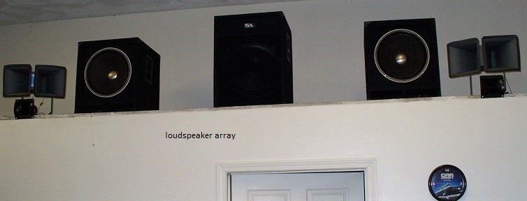

5. Loudspeaker stage: an array of large, efficient loudspeakers (still my preference) accepts power amp output.
All are described below along with the software involved, working backwards from the end point (speakers) to the source desktop.
The loudspeakers are 3-way and flank a sub. They were chosen for efficiency, clarity, durability and affordability (less than $1500) and are as follow:
Subwoofer: a $240 Seismic SAP-18S is a downfiring 18" driver/cab with which I am quite pleased. It retains the 18" Seismic driver, but the integral passive crossover is bypassed. It crosses over to the woofers at 70hz 42db/oct. Besides providing deep lows, it unloads high-excursion frequencies from the woofers.
Woofer (each): a modified $150 Seismic 15" sub cabinet houses an Altec 421A bass driver. The resonant frequency of the cab is ~31hz, identical to that of the Altec. The cabinets required a bit of mounting hole widening with a drill-mounted drum sander and notching with a round file to front-mount the Altecs. An integral passive crossover in the cabinet is bypassed. The assembly crosses from the sub at 70hz 42db/oct. and to the midrange at 300hz 66db/oct. The 421As (or the very similar and more common 421-8H) are generally available used or reconed for ~$100 and are, IMO, among the best low-mid drivers ever made.

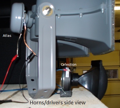

Midrange (each): an Atlas PD-5VH Alnico compression driver feeds an EV/University Cobreflex horn, functionally identical to the horn that once graced University systems like the 'Corner Dean'. The modern incarnation is of ABS rather than cast aluminum. It has a 250hz cutoff and loads the Atlas driver well. The Atlas is mentioned on Klipsch fora as a good mid replacement for the Klipschorn. Together they cost ~$300. The unit crosses from the woofer at 300hz 66db/oct., and to the tweeter at 2500hz 90db/oct.
Tweeter (each): An Eminence APT-200S biradial ABS horn loads a Celestion CDX1-1010 driver. They are a good match, the driver being loaded smoothly by the horn from ~1500hz to beyond audibility. The horn is mounted with its biradial flares horizontally opposed. It crosses from the mid at 2500hz 90db/oct. with a 45khz 30db/oct. rolloff. The cost of driver and horn together is ~$40.

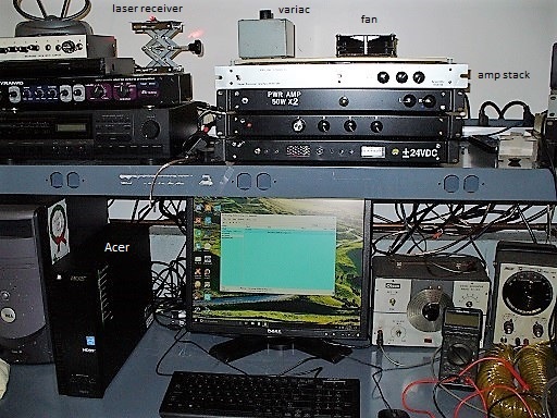

Power amplification for the woofers and sub comes from three tiny stereo boards with TDA7492 and its class D support circuitry, ~$14 apiece. I have little information about them, but they seem to be based largely on basic prototype layouts shown in the chip manual. Though they are stereo boards only one channel is used, resulting in one board per woofer and one for the sub. The large and efficient speakers demand little power to overwhelm my 'room', a 47'x28'x12' garage. The amps are rated at 50w/ch (which they never approach) but my tests observed a board with one channel used throw more into an Altec test driver without scope-visible or audible distortion, something easy to hear at a test frequency of 150hz. The boards are mounted in industrial surplus 1u rack mount boxes (one for woofers, one for sub) each with its own regulated 24v switching power supply (about $30 apiece). The sub supply is housed in a separate rack box for historical reasons. The mid and high horn pairs are powered from one more box, a single supply driving two Sure AA-AB32971 'class T' stereo amp boards. These were used for the horns in hope that smoother output and improved phase behavior at higher frequencies might be obtained from a higher switching frequency. However the Sure boards have audible fans that go on and off constantly. The addition of a 5" AC box fan atop the case (run through a small variac at low speed) seems to provide enough quiet airflow to keep the onboard fans idle.
'Line level' tier processing is broken up a bit more. It has a source side and a crossover side, each housed in a separate desktop but doable in a single desktop if so desired. Note: I have tested both methods and heard no difference. Note: It is possible to eat CPU with certain DSP applications/settings and this becomes likelier using a single desktop, especially if it is not a dedicated audio machine.
We begin with the crossover side, still working our way from back to front. A $250 Acer Aspire SFF desktop (with mouse and keyboard, half that price if refurbished) got an old unused Dell monitor via a $20 hdmi/vga adapter. A usb wifi adapter was added as no wifi card came with the unit, but a $50 Bearextender was needed anyway for range. The other h/w augmentation was a 7.1 PCIe x1 sound card. This is worth discussing. Startech, Vantec, SIIG and others make what should be roughly equivalent cards, each ~$45. Each uses a CM8828 chipset. I have the Vantec and the Startech. The Acer came advertised (from the vendor) as having a single MiniPCIe slot but inspection happily revealed a single PCIe x16 slot. It also has two half-height expansion blanks on the rear panel. The Startech comes as two cards, one simply mounting the 4 stereo minijacks and connected to the processor card via supplied ribbon cable. The Vantec is a single card using a mini-DIN connector with minijack fanout. Both include optional half-height face plates permitting internal mounting on a SFF desktop. The driver is configured as 7.1 surround with 192k/24 (max) throughput to the onboard DACs. Additionally, each card comes with stereo Toslink 192k/24 (max) I/O ports. The input is used to feed an spdif signal to the machine. The Vantec is currently in use; both work fine.
A number of mostly freeware/donorware apps and plugins were downloaded once Windows 10 (preinstalled) was updated. The core app, foobar2000, was given plugins for external input (recording) and VST accommodation. The DSP loaded was Convolver-VST. This is the crux of multi-driver stereo crossover operation and is configured for 2 channels in, 192k sample rate, 4 partitions, 8 FIR processing channels and 7 channels out (subwoofer FIR channels are mixed to L+R mono). Each FIR is Linkwitz-Riley 32k-FFT (16k taps) 24-bit, generated by RePhase for 192k sample rate. The frequencies and slopes are mentioned in the speaker descriptions. RePhase permits mixing paragraphic EQ curves with the crossovers. This capability was used (e.g.) to ramp up midrange output past about 1.5khz to compensate for slight rolloff in the big Cobreflex horns. Convolver-VST's configuration file includes channel matrixing which, in my case, permits mixing LR sub channels to one mono output. It also provides wide programmable delay on each channel for phase alignment.
Across the garage, an existing Dell 3646 desktop was also fitted with foobar2000 and the accoutrements necessary for 192k/24 USB stereo output. Note again that I could simply stream music or rip cds directly onto the Acer and have it do all the work but wanted the ability to control source from my office. Thus a ~$35 box housing a CM6631a USB/spdif converter board was connected. Its output feeds a modified $15 coax-to-optical converter from which the toslink module was removed and a trimpot added to provide some DC offset to the output signal. The wall-wart power supply was replaced by a small $15 5V switching supply. The unit drives a $1 (!) 6mm/650nm laser module, embedded in a modified 12mm housing for easier mounting. The cmos inverter in the modified converter provides plenty of current to drive/modulate the laser. The receiving end of the data link can be an optical-to-optical device but I simply mount one end of an optical cable onto a small lab jack to adjust for slight vertical beam deviation with temperature/humidity. It feeds the laser signal to the soundcard's optical input. The laser has become another reason labor remains divided between the two desktops since I enjoy testing and improving it. Currently it has logged perhaps 1000 hours of operation without complaint.
Foobar2000 on the Dell has added DSPs also. A SoX/mod2 resampler plugin upsamples input to 192k and feeds a FIR equalizer. The EQ of choice (at the moment) is ReaFIR which offers up to 32k FFTs and adjusts automatically to sample rate, but its salient feature is real-time graphic adjustment capability. WASAPI or ASIO 24-bit output feeds the CM6631a's USB driver, to be sent via laser to the Acer. Music is sourced by streaming, downloads, ripped CDs or whatever common means. Both desktops have been given 8G memory upgrades at ~$50 each, which is totally optional.

5. Some pictures and a diagram are attached. The Dell source desktop is omitted; it's not a very interesting photo subject.

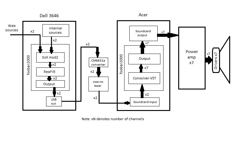

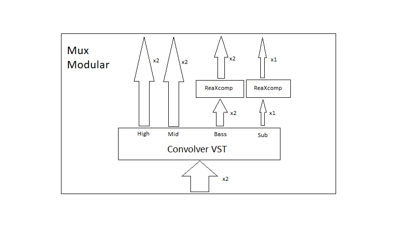

For those who may be interested, I have an update. As I mentioned in the post, things can change fast. The description as given remains valid outside of the following mods.
1. Speaker mod: I swapped out the HF compression driver. I had a couple of Celestion CDX1-1446 drivers mounted on now-unused CD horns. I replaced the CDX1-1010s with them. The result is a smoother response and lower cutoff frequency capability.
2. Crossover mod: The new HF drivers permitted lowering the xover point between mid and hi, so I also explored lowering the low-mid xover point. The Atlas drivers are spec'd to go quite low; the only question was whether the Cobreflex horns, spec'd to cut off at 250hz, could be taken smoothly to that point, beneath which they naturally roll off at 6db/oct. Scope/mike tests indicated no clipping, good waveforms and smooth gradual rolloff as the horns unload. Thus, the new points are:
sub-low: 70hz, 42db/oct.
low-mid: 250hz, 66db/oct.
mid-hi: 1800hz, 90db/oct.

3. I have always liked dynamic expansion, having built expander/compressors in the '80s from the Signetics NE572 compander chip. This time around I used software. The crossover machine was fitted with MUX Modular VST, which now solely inhabits the Foobar2000 DSP stack on that machine. It hosts the other VSTs, including convolver VST (as used before). The reason for its addition is that it affords a connection patch-matrix so that I can add expanders only on the bass/sub channels. These are ReaXcomp VST instances, set to less than 1:1 compression ratio and hence functioning as expanders. This was done to help the direct radiating bass drivers match the dynamics of the horn-loaded mid and high units. Meanwhile, on the stereo source machine, a third instance of ReaFIR is now inserted prior to the two ReaFIR equalizers in the DSP stack. It is set to 'compressor' mode at less than 1:1, providing slight expansion for the entire spectrum. The results are very good.
