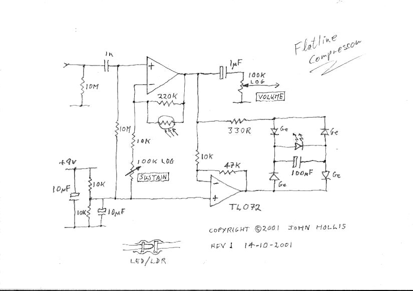

I soldered up this circuit today to find that it is utterly useless.
An output of 70mV from line level input.
bah! what a waste of time

What a waste of time? You learned something!
Interesting circuit, but it will not do to send clean audio to a mixing console! Low distortion compressors can not be build with 10 parts.
Go to thatcorp.com and check on their app notes on signal processing (parts THAT2180 and THAT4301)

Thanks a lot mickeymoose. That site has a pretty comprehensive array of designs. I'm looking at the "one knob squeezer". http://www.thatcorp.com/datashts/dn125.pdf
It is slightly going against my original idea. I want to design simple veroboard diagrams using easy to find, straight off the shelf parts. I want to compile a bunch of simple audio circuits so that other people can reproduce them easily.

I'm currently working on a veroboard design of the "flatline compressor"

don't know if this circuit is worth a try?
That is exactly the circuit I made the other day.
I must have checked it twenty times trying to find something wrong with it, but even on my guitar amp, it attenuates the level way too much.
I guess you don't get anything for nothing. looks like passive isn't the way to go.

Easy is not a substitute for top audio quality but you can give it a try - use v2. It's going to be less noisy than the NE570. Small Bear Elec has some of the chips for sale.
