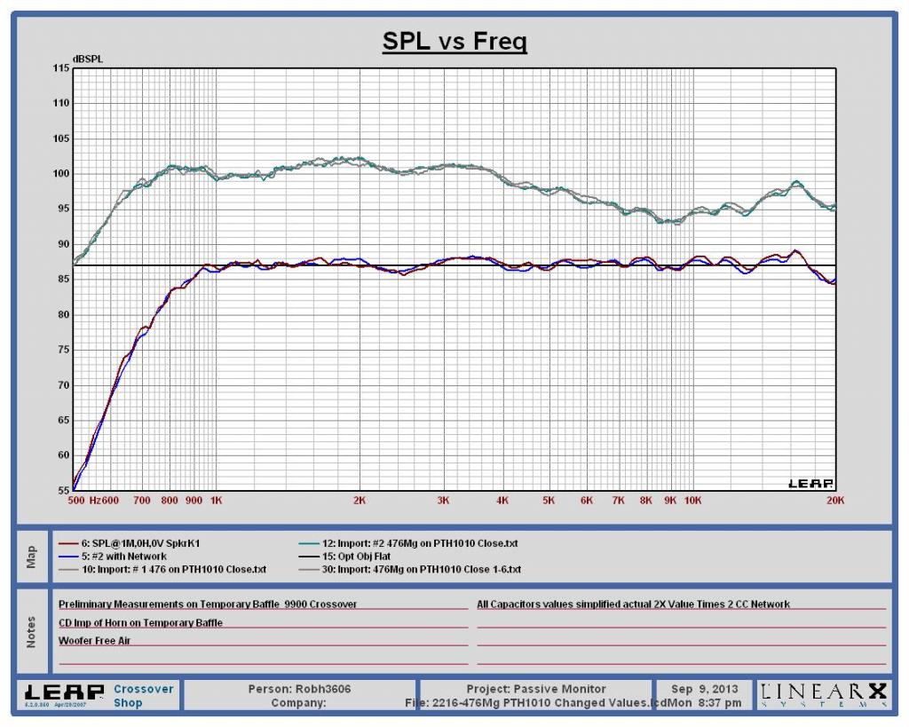

I have systems that use the 435Be and 045Be combination and the 476Mg solo. Build with what you have, if you do it right it will be just fine.

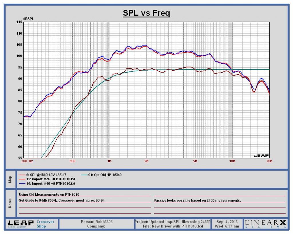

The 435Be’s are great drivers but they do roll off above 10K or so. I like passive set-ups and with the woofer setting the system sensitivity that roll off can be an issue. Attached is a measured pair of each you can see what the differences in roll off are between them.
The larger 4” have a longer phase plug in comparison and have less roll off. As far as Ti drivers the aquaplas coated JBL’s 4” sound quite good.
The 045Be is one hell of a tweeter although the sensitivity is a bit low. I would certainly have a listen mine are crossed at 6-7k so I can clearly hear them.
Running active make sure you have protection caps in line with both the 435Be and the 045Be. Expensive whoops if you DC them. A real issue with active is noise and not using the 045Be and adding EQ is going to drive up the noise level.
You would be better off using part the existing passive network if you can and potentially bi-amping. That puts a protection caps in place and the built in attenuation lowers the noise floor.
