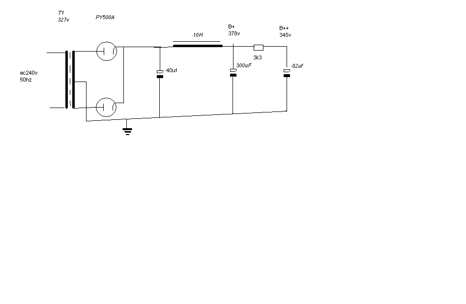

Hi!
Today i got a visit from a friend who works as a sound engineer.....
I let him listen to my amp....the first thing he said was: the sound is compressed
(like altering it with a compressor which you use for P.A)
The only thing i can think of is....the coupling caps
(0,47uf/450v)
The pre-amp/splitter has been improved to the one in the schematic (5965)
The coupling caps never have been changed....but i have no idea if this is the problem or even wich value they should be
i could really use some suggestions

@svokke: could you find anything in the psu???
hi
nothing sure but maybe:
1-your friend listen all day very neutral transistor sound
2-change 3.3k by irf820 to create a small 300v regulator
like me easy to put inside your box
3-jump up 300uf to 500 or 600
4-remove c4 c5 = -gain but +linear just for see
5-upgrade 317 ccs to a good transistor ccs like c4s
but the reverse one version for cathode side
@robert morin
i tried biassing the tubes to approx 8,2ma (7,9)
I lowered the anode resistances from 39k to 22k
bias is now -1,56v
VA is 155v
7,8mA per triode
I also lowered the 3k3 resistors to 1k5
The sound seems a bit clearer but still has the 'curtain' effect....bass is MUCH less, busy music gets a bit garbled up
Hmmm,after some time these 22k resistors run quite hot
Maybe it's my speakers....

hi,
@sch3matic(@dj middelkoop for the trannies)
Well... i changed a lot to this amp. output transformers from 10k that caused oscillation to 6k that don't. upto this new splitter stage...and the power supply.
I got some REAL good technical help from mattijs de vries (www.machmat.com)
to be honest i'm just a beginner with not so much technical background and the only thing i hadn't changed where the coupling capacitors
And after reading how they can affect bandwidth....i made an assumption....
but after reading some more it seems you can just 'set' them at where they begin altering, usually dis is thone way above 20khz and somewhere around 10 to 20hz...
I am led to think this has been properly done in anna's first design so (assuming) even with these new tubes it wouldnt give a dramatic difference
@robert morin
I know now that (if i understand mattijs's explanation). the lm317 at the cathodes of the 5965 provide an almost infinite rk. The choice is to use litlle current into a big load...so that the load line gets more horizontal... and it doesn''t matter much where the tube is being biased...
changing the bias point of the 5965 didn't help, it merely got things running quite hot:
The biggest mentioned here are:
- remove autobias which puts a big elektrolytic in the signal
* ok worthwile AND nice to try...the auto-fixedbias design from www.machmat.com (diy-kit)
- use ccs with a transistor.....(or tube???!!!) instead of the lm317
It seems i now know what i have to be doing!! buy stuff!!!!
Thanx a lot!
:- my: guess....within 6 years....NO part of Anna will have been in the original one -:
Ok you're making progress here.
Try the fixed bias from Matthijs.
Matthijs is very knowledgable, following his advise will shurely help.
You're right with the coupling caps, the values are ok, leave them for now.
When your amp start sounding better you can try other brands to hear the sonic impact.
I don't use the 317 for CCS but use transisitors or (mos)fets.
So I cannot tell you if this will make an improvement.
Dick.

Hi!,
Thank you all for your tips!
This morning i tried something else....i removed the 100ohm resistors from g2....
Well believe it or not, but this did do something....it clears up!
just to remove something!!:cannotbe:
this in combination with the automatic fixed bias module which will arrive next week will do a lot of good, i'm sure!
