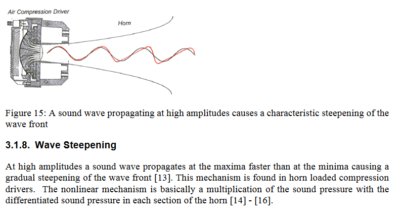

Assuming you mean "compression driver & horn combination" vs dome tweeter directly in baffle, which would be the usual case, the causes have been plenty identified:
https://jblpro.com/de/site_elements/tech-note-characteristics-of-high-frequency-compression-drivers
High frequency distortion in compression drivers is basically a thermodynamic phenomenon. It results from the existence of high acoustical pressures at the diaphragm-phasing plug interface rather than from mechanical non-linearities in the moving system itself.
the same non-linearities which give rise to second and third harmonics will also cause intermodulation distortions of frequency modulations in midband, and these will be quite audible.
https://www.klippel.de/fileadmin/_migrated/content_uploads/Loudspeaker_Nonlinearities–Causes_Parameters_Symptoms_01.pdf
Direct radiating dome tweeters of course also have a completely different radiation pattern than a compression driver in a horn, which leads to different room interaction. But, the sharpness and hardness that listeners dislike about compression drivers, that dome tweeters don't have, is a natural and unavoidable result of the compression chamber and horn loading. It inherently increases both sensitivity (good) and nonlinear distortion (bad).
