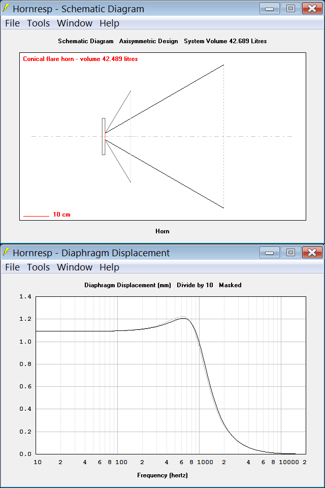

If it's driven with the same voltage, SPL will be different. What would be interesting to see is what excursion is needed to reach a given SPL at some distance.
Quite recently I made a similar comparison: Acoustic Horn Design – The Easy Way (Ath4) (#7876)
As you wish. Here are two horns. They have very different cutoffs, more than an octave and a half separation of the acoustic impedance slopes.

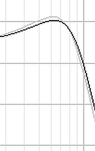

I took those models and put them on a compression driver to see what it's displacement would be like on each horn. As shown, they are similar.

Why is the excursion linear down to LF? I have found that the excursion has to double each octave down to put out the same SPL. What about normalization if the driver needs eq at LF in a short wg? I think you need to account for this in the pictures.
mabat also correctly pointed out differences in output... This is not what I set out to do. The need to use EQ would simply have shown my point.docali said:What about normalization if the driver needs eq at LF in a short wg? I think you need to account for this in the pictures.

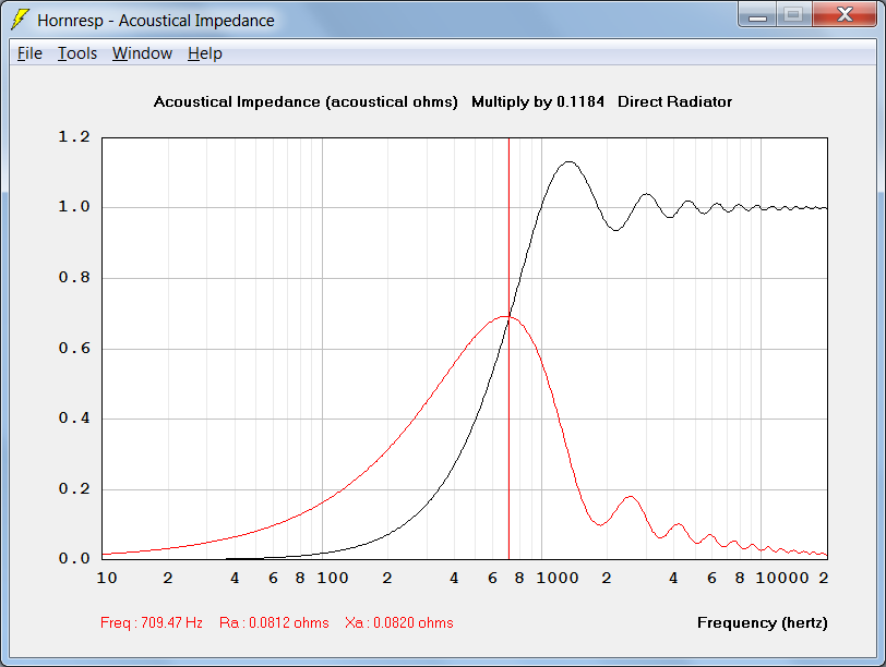

When selecting an existing device.. does cutoff apply to finite horns? What happens outside the bounds of Webster's equation? Is it the same for all horn types?
I don't apply the term to waveguides. I don't know what to expect when a number has been quoted by a manufacturer.. often lowering the cutoff doesn't have the expected effect. One of the best ways to know what you have is to measure it.

If you look at your impedance traces you see it indeed is. When the situation for the driver is in no way different from sitting in a WG/horn, you have to say that the "loading" is lost.
I dint understand why you keep holding this position - its so obvious and logical. Then the SQ impact under certain circumstances might not be that severe, but still...
So when is the loading lost for a direct radiating midrange or a woofer, for example? It's exactly the same question. It's never lost. It's all about the drivers capabilities to produce required SPL in a given situation. As long as it is capable, there's simply no problem. I don't understand at all how can people still obsess about this.
Who ever looks at the radiation impedance for a woofer?? It is almost nil at the very low frequencies. So what? All that matters is whether is the woofer capable to produce the SPL required or not.
Never because it was never loaded with anything else than the air facing the cone with no transformation ratio to help it "connect" stronger to the air.
The whole loading thing is about a transformation ratio > 1.
There doesn't have to be a SQ impact.Then the SQ impact under certain circumstances might not be that severe,
Acoustical transformation ratio=1, no loading.
Acoustical transformation ratio>1; loading.
Nice graphs.
The SPL variation still needs to be EQ'd for a real system. It would be more interesting to EQ the system flat on axis 500-15K then see what the difference in excursion is across the FR. Even a 20dB (+/-10dB) total correction means 10x variation in drive voltage and 100x variation in applied power.
