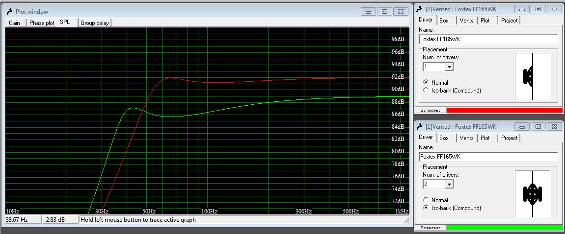

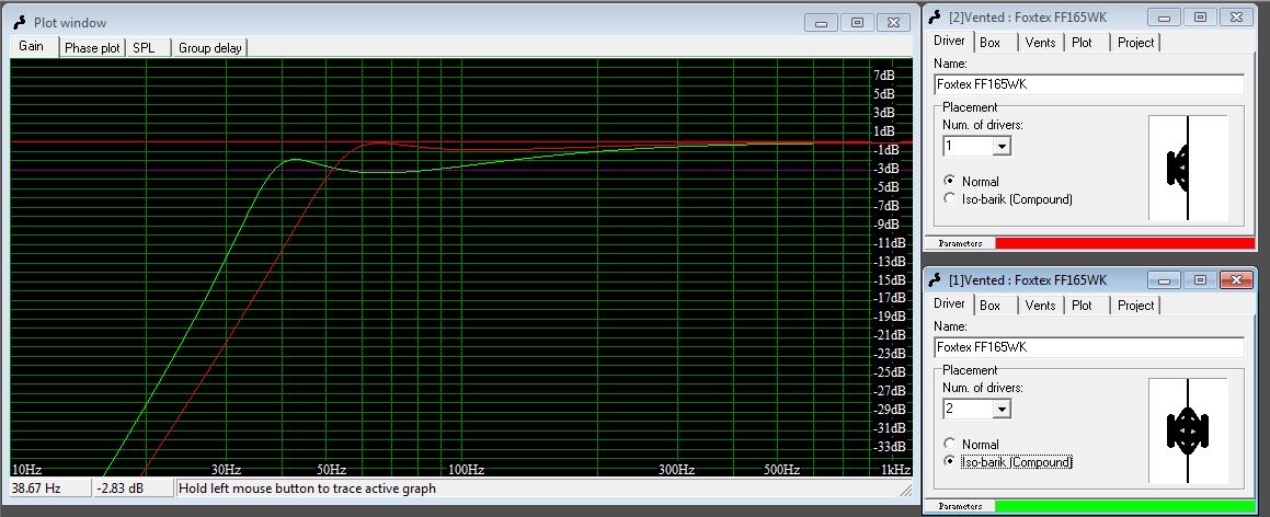

Re - Isobaric enclosures
@ Thetwinmeister
Hi, fs is NOT halved ! It along with many other T/S's remain the same. It's Vas that's halved 😉
Anyway, i'm following your thread with interest. All the best with your endeavours 🙂
@ Thetwinmeister
The two drivers operating in tandem exhibit exactly the same behavior as one loudspeaker in twice the cabinet. The cabinet is defined as the space behind the rear driver. The volume of air between the speakers has no acoustic function so that the saved space is less than 50%. All other aspects are unchanged like resonant frequency and maximum SPL. The new driver will have the same resonance frequency, Qts, distortion, excursion etc. as one driver with the same applied signal https://en.wikipedia.org/wiki/Isobaric_loudspeaker
Hi Zero D, it's good you pointed this out. It's high time I tested the drivers empirically with my DATS in parallel, series, and individually to shed some light on this question. Prior to building my isobaric sub, I read similar articles about isobaric and believed Fs did not change.
Perhaps it doesn't change, perhaps it does change a little but isn't halved. I should have confirmed with test equipment by now what my ears have observed-- parallel has the least LF extension, series has greater extension, and discretely driven seems to have the greatest extension.
I could be imagining things however, so I reserve the right to change my opinion. 😉 So far no direct A/B tests have been performed on this. I will have the time to test the drivers next week. Until then!
@ Thetwinmeister
I agree that there could be a shift in fs. Variations in drivers T/S, & Volume of the shared enclosure, being just 2 possibilities that spring to mind !
@ Joseph Crowe
We've all done it from time to time 😉 I thought it best to point it out ASAP so others reading it too are clear on this.
